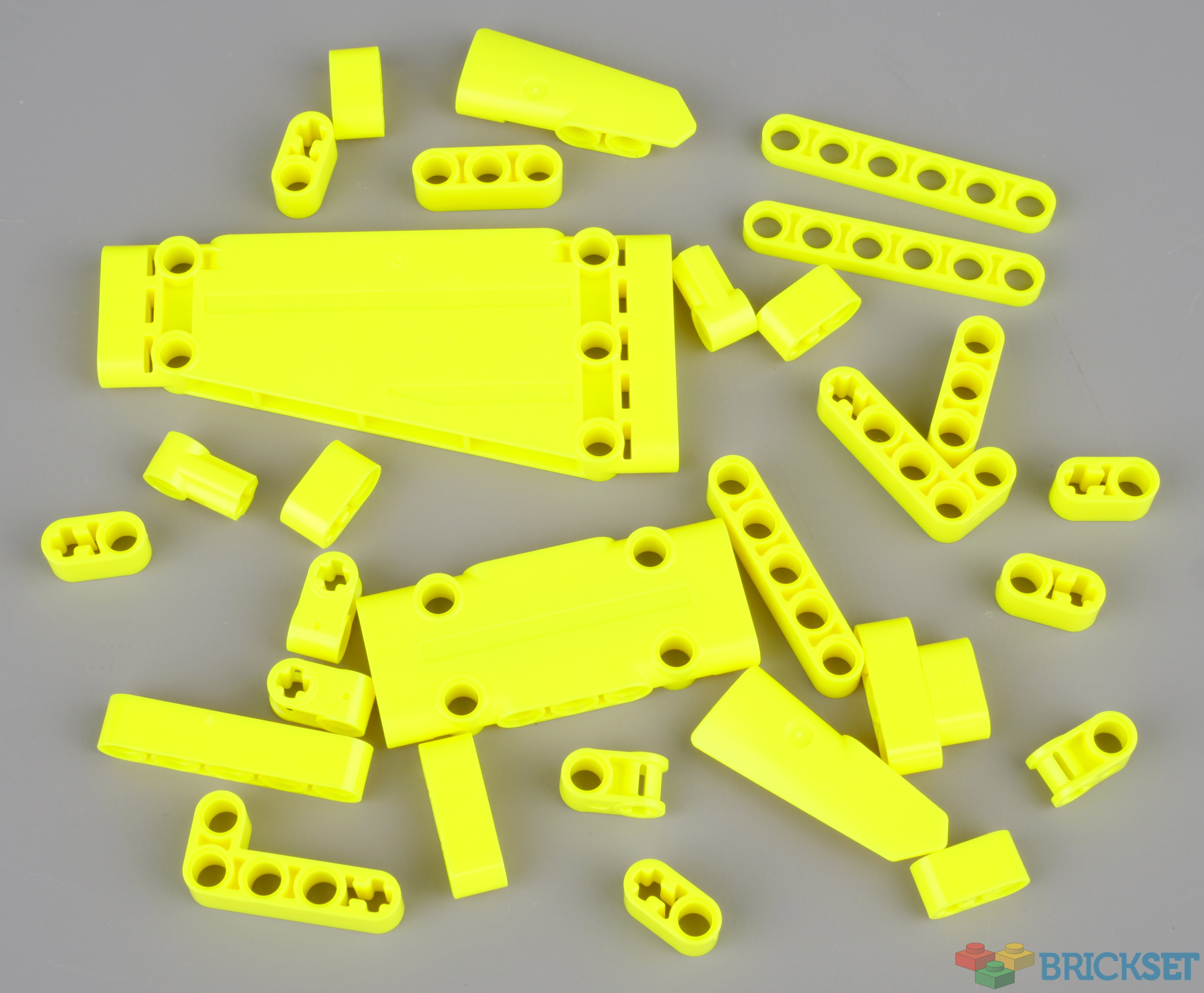

I didn't realise when first viewing images of the model that the yellow parts in it are actually the new vibrant yellow which was introduced this year, and this is the first Technic model to use them extensively. Decorations are provided courtesy of stickers and I must apologise for not photographing the sheet before applying them.

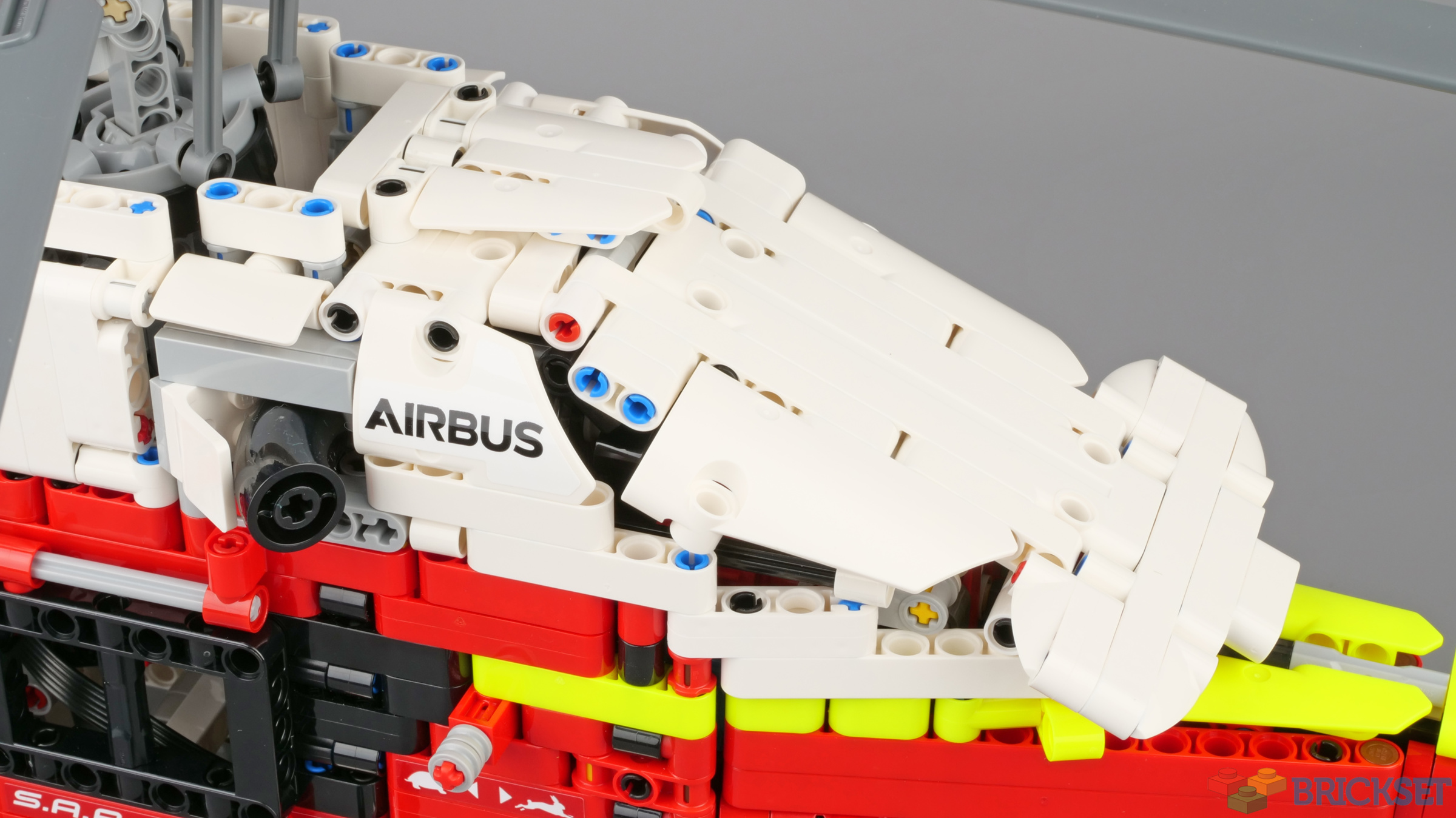

The white cowling around the engines and rotors at the top looks a bit clumsy in places compared to the sleek curves of the real thing, but otherwise the bodywork is seamless and looks pretty good.

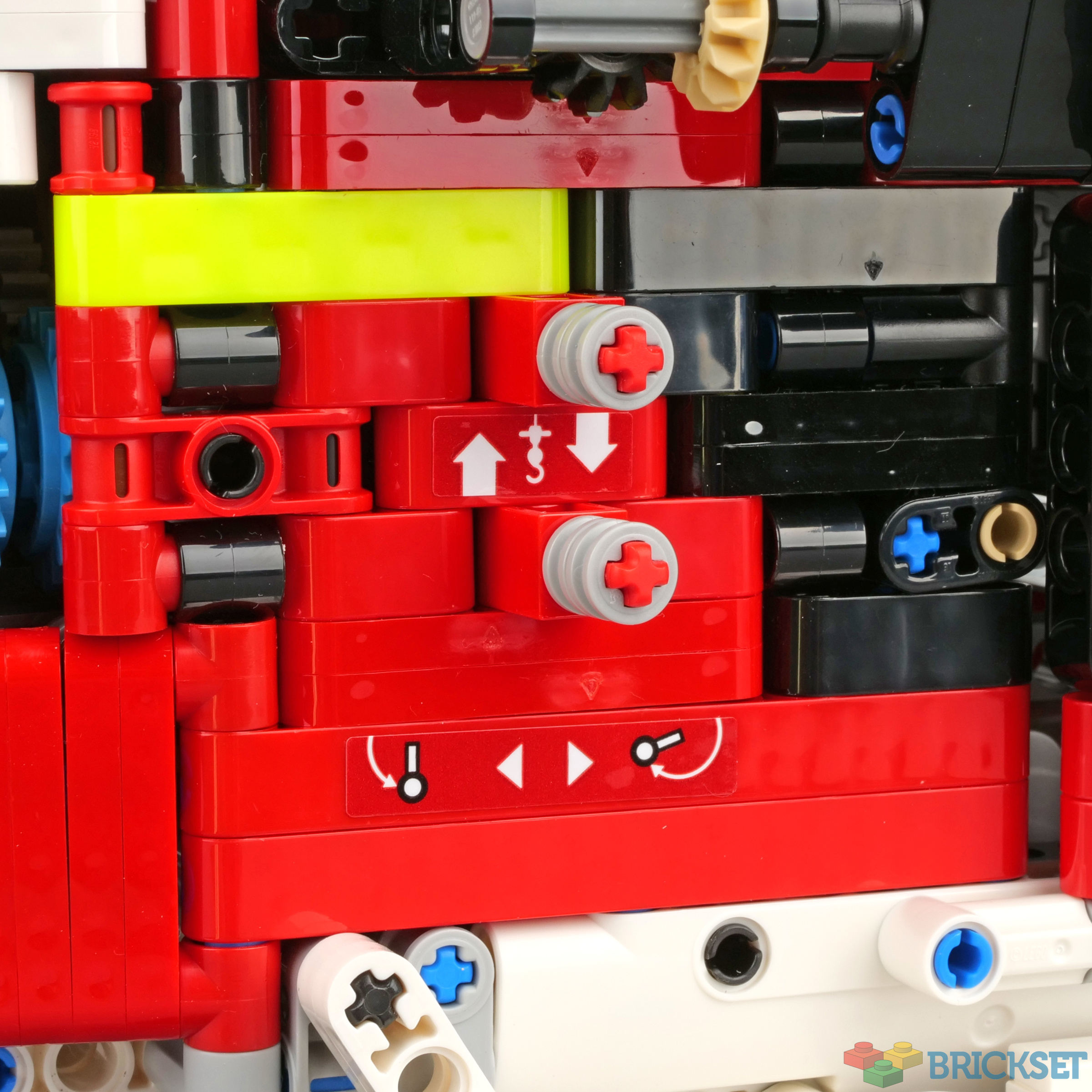

The motor is powered up by means of a switch on the side. Additional controls are then used to operate the motorised functions via a gearbox.
Flicking the lever above the on-off switch turns the rotors, which can be set to rotate either fast or slow. The stabilising rotor at the back is of course linked to the main one and rotates with it.

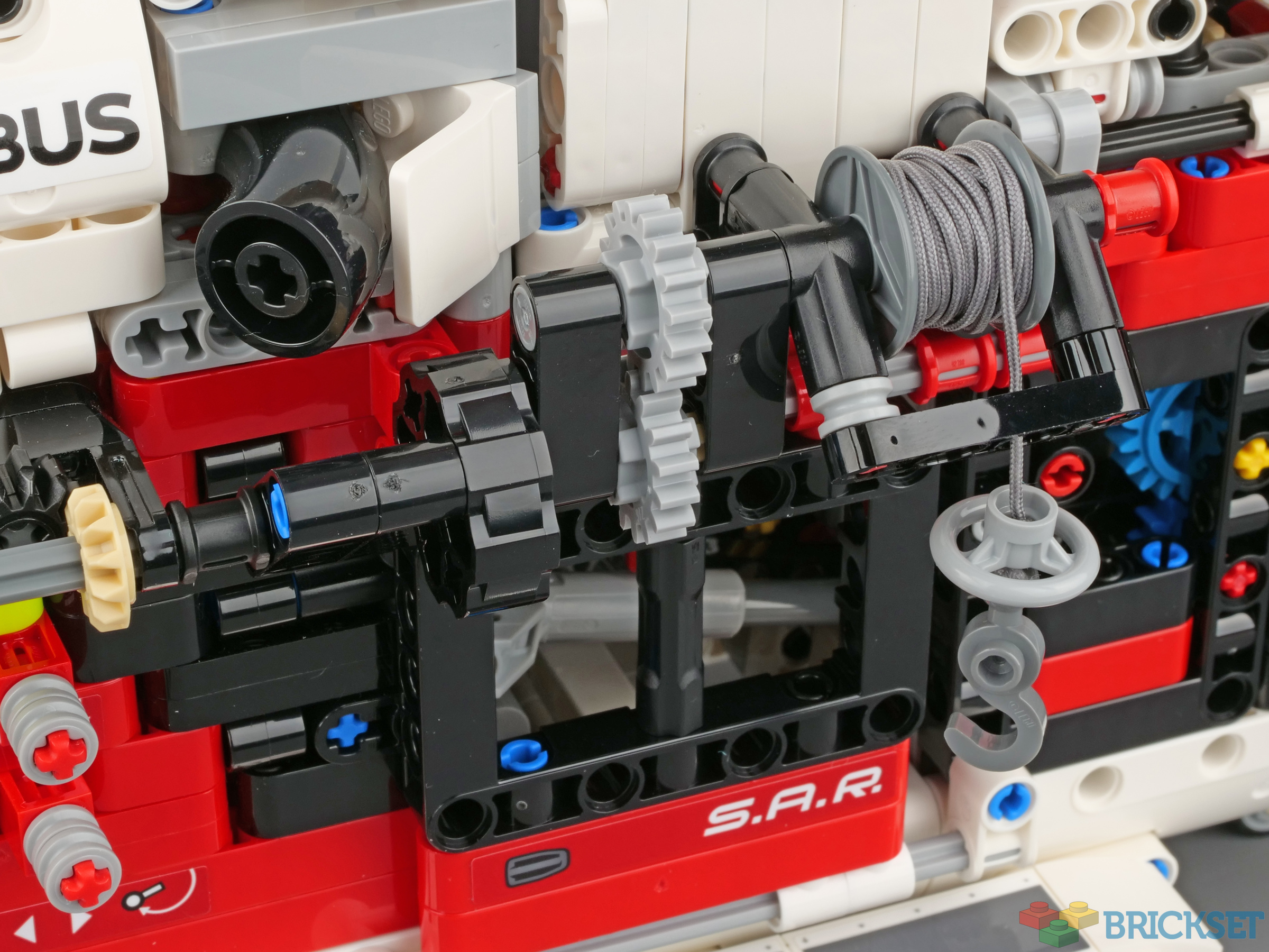

The switches on the other side control the landing gear and winch. All three can be powered at once should you wish, although the landing gear would soon hit one of its limits and cause the clutch to slip.
The winch is positioned on the right side of the fuselage

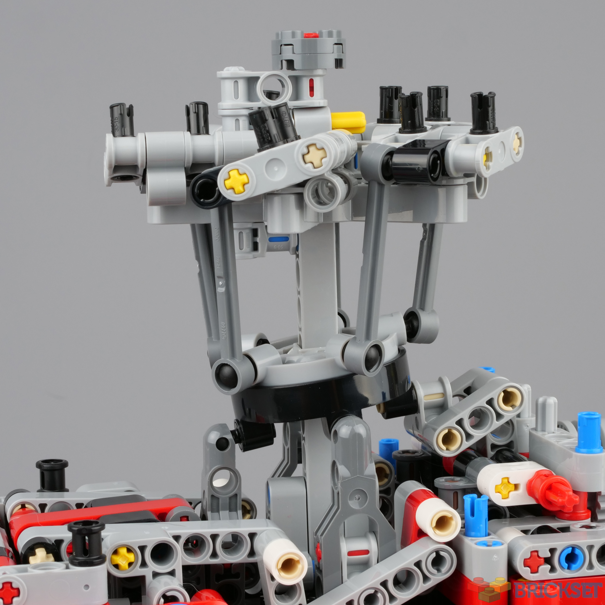

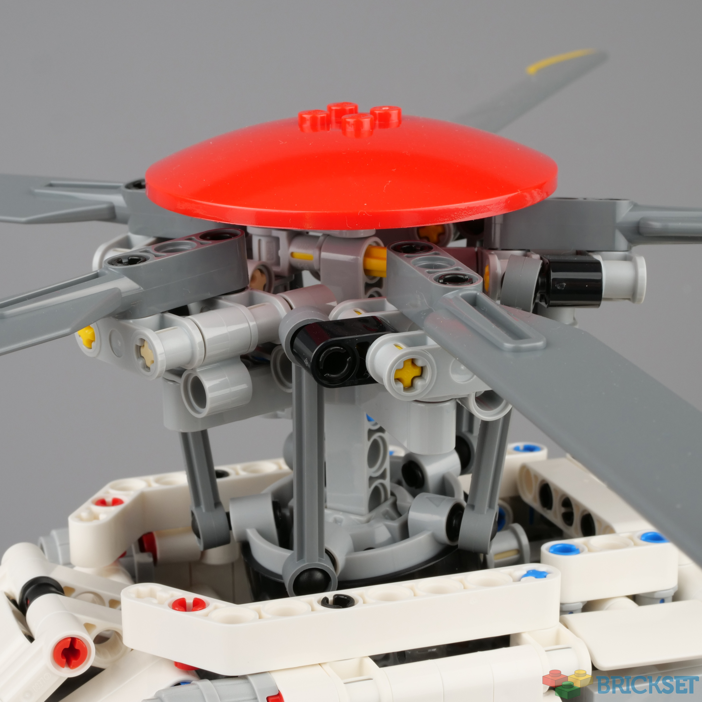

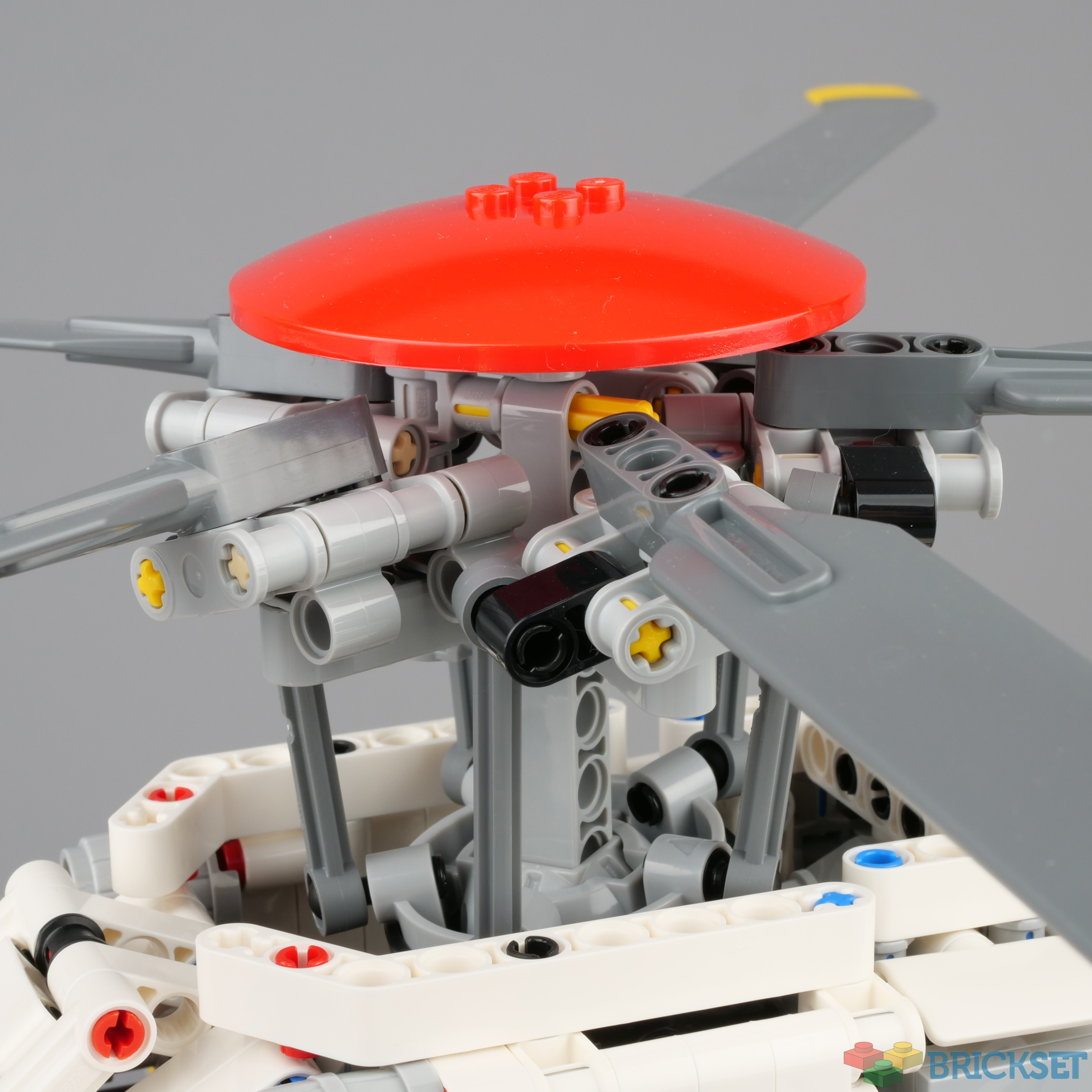

The mechanical functions that control the rotor blades are actually more impressive than the motorised ones.

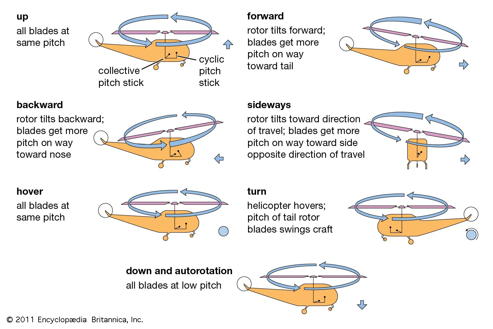

In real helicopters the pilot uses a collective pitch stick and a cyclic pitch stick to adjust the pitch and tilt of the blades, via a swashplate (the device below them that translates input from the helicopter flight controls into motion of the main rotor blades), and as far as I can ascertain the corresponding controls on the model work exactly as they do on the real thing.
There are dual controls in the cockpit, allowing either the pilot or copilot to operate them. The cyclic sticks are in front of the seats, the collective sticks on the left-hand side of them. The latter can also be operated from outside the cab to make it easier to do so.
Here's a good diagram showing how they are used to control the craft:
Source: Britannica
The range of movement is fairly small, as I imagine it is on the real helicopter, but you can hopefully see a difference in the pitch of the blades when the collective pitch stick is moved from one extreme to the other in the photos below.
It's a very complex and clever mechanism that's been neatly concealed within the fuselage.

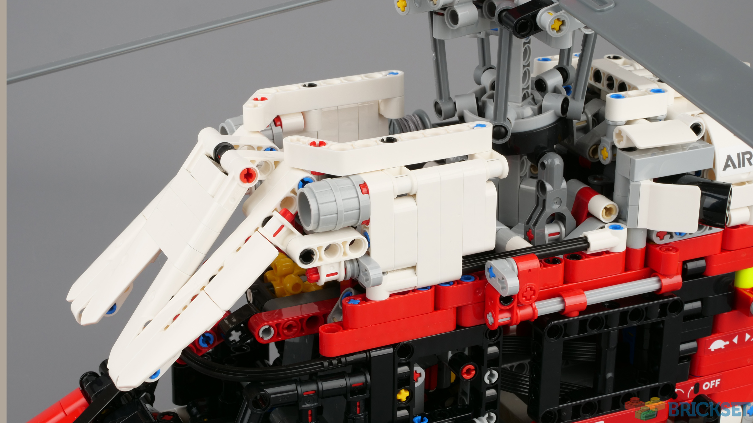

The cab doors swing open and those behind them slide backwards. Also, impressively and ingeniously, the white sections of bodywork fore and aft of the rotor can be slid back and forth to reveal the mechanism inside, including the swashplate and mock engine, which rotates with the rotors.

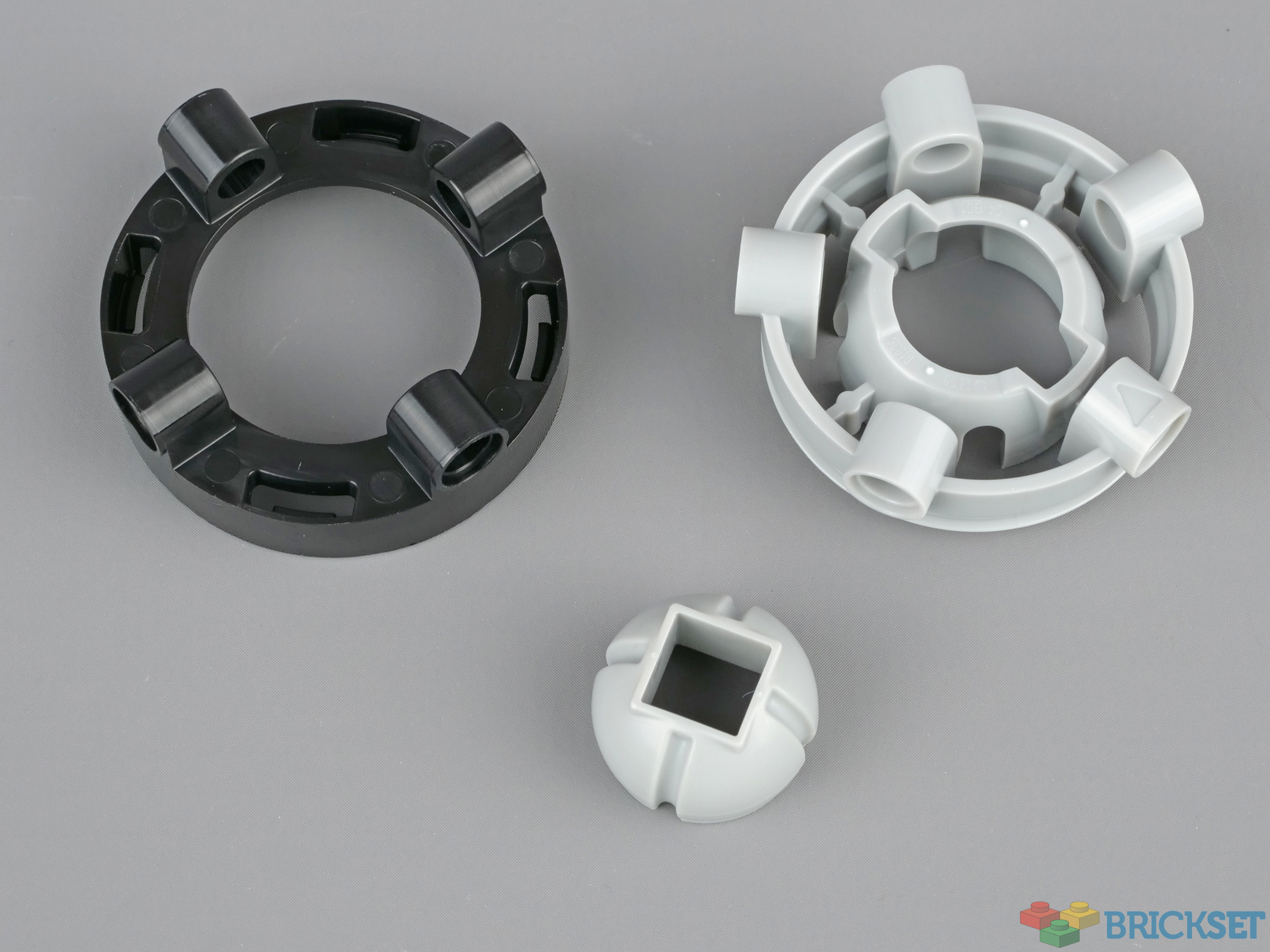

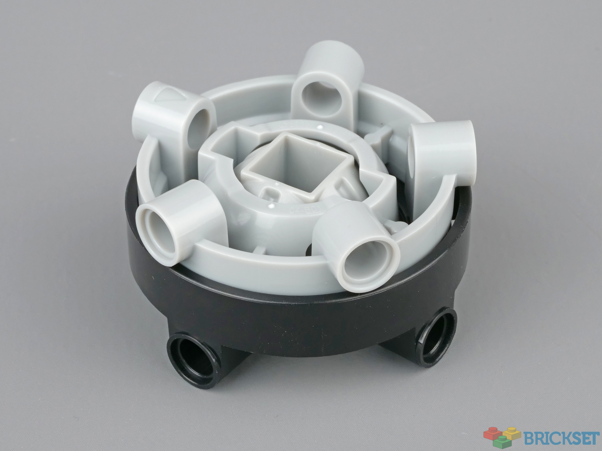

New parts
Unsurprisingly, the complexity of the swashplate and the need for a 5-bladed rotor has necessitated some new parts, including a three-piece turntable that can turn and swivel around a technic beam threaded through its centre square hole.
The unusual geometry of this element is likely to provide some interesting possibilities for MOCs.72 degree angles are nigh-on impossible to create with existing pieces.
There is a good variety of pieces cast in vibrant yellow, but personally I think it looks cheap and nasty, and very un-LEGO-like.

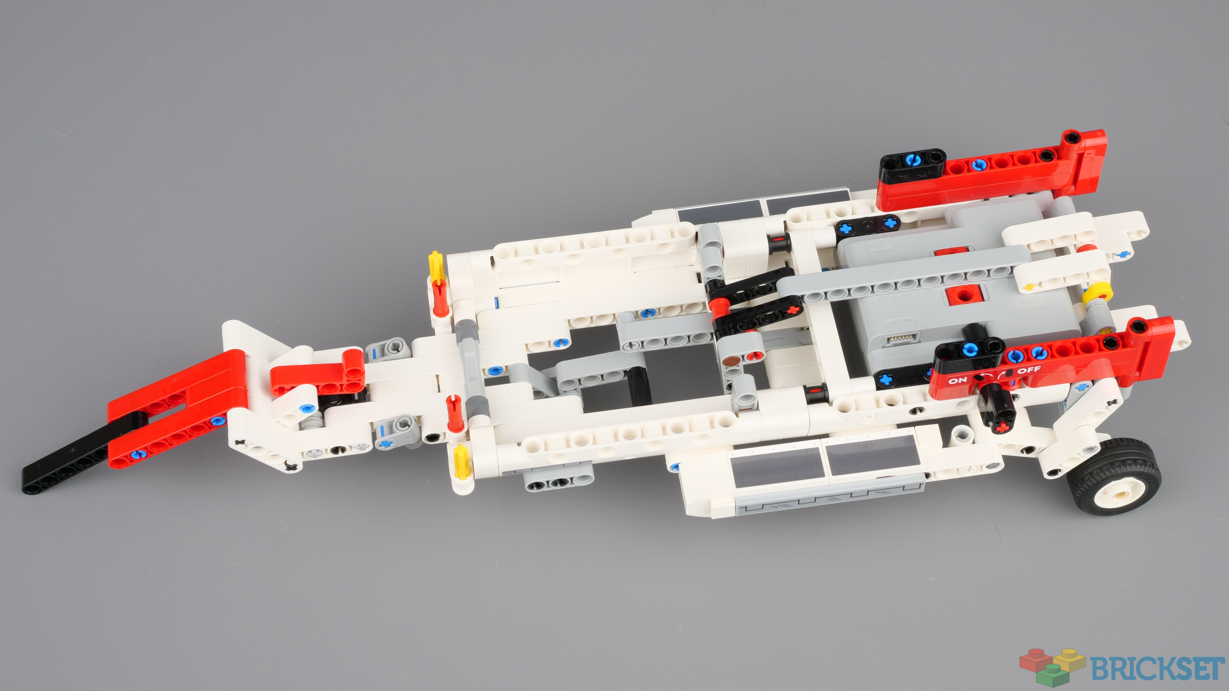

Construction

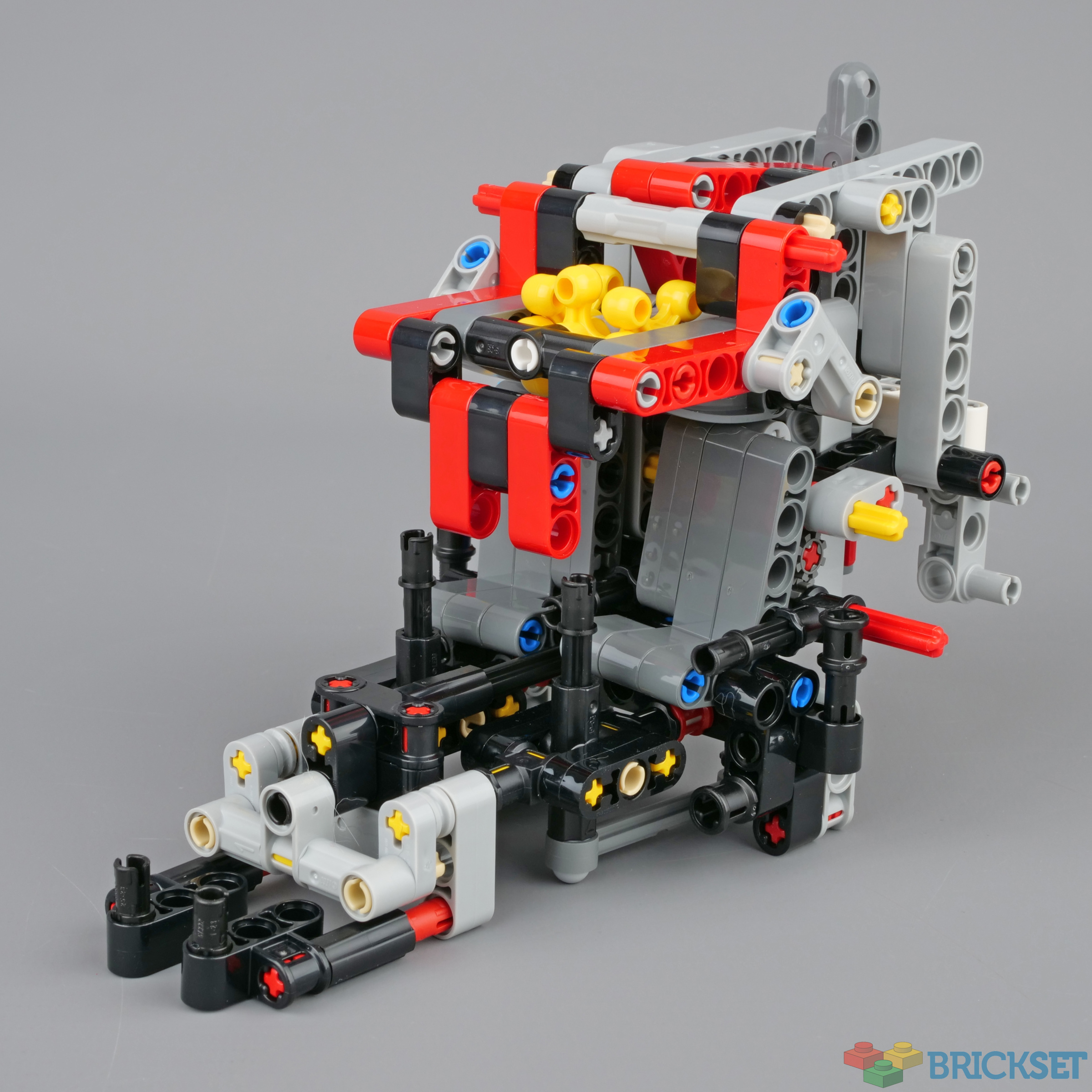

The Control+ battery box is positioned at the bottom to facilitate changing the batteries, although it's a bit of a faff to do so when it's in-situ because it's one of the new design of box that requires a screwdriver to take the lid off.
This first section to be built also houses the retractable landing gear.

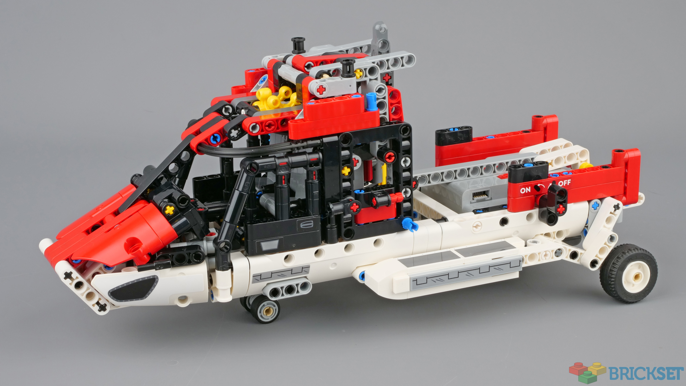

The linkage between the pilot's controls and swashplate requires a complex assembly behind the seats.
Compared to that mechanism, the gearbox in the middle of the fuselage is relatively straightforward.
The tail section incorporates most of the vibrant yellow pieces
Prior to adding the cowling around the top it's worth taking a look at how the new pieces are incorporated into the build.
The turntable can be tilted forwards, backwards and side-to-side which in turn affects the pitch and angle of the blades.

I like the idea that the engine cover can be opened to show the internal functions. But I also dislike its shape / appearance.
That seems to be unfinished because it appears to be -very- different from the original.

For anyone wondering what the "autorotation" in the diagram is, that's what a helicopter does in cases of engine failure.

Interesting, I was just surprised that the rotor blades are pitched down in the picture demonstrating the collective control.

@saabfan said:
" @Huw said:
" @saabfan said:
"Great review! Is it possible the rotor blades are attached the wrong way around though?"
No, I think they match the official images and instructions."
I noticed that too. It seems like the cyclic stick is set so the blades toward the back of the helicopter are pitched up more than the blades in the front, so when the collective pitch increases from the first picture to the second, they go from front blades pitched down and back blades nearly level to front blades level and back blades pitched up. Look at how the swash plate is tilted in both photos.
@tne328 said:
"I noticed that too. It seems like the cyclic stick is set so the blades toward the back of the helicopter are pitched up more than the blades in the front, so when the collective pitch increases from the first picture to the second, they go from front blades pitched down and back blades nearly level to front blades level and back blades pitched up. Look at how the swash plate is tilted in both photos."
True, that makes sense!
I'm ok with the fluro-yellow pieces - it definitely gives the set a 'Search & Rescue' feel. It's not perfect - there's a bit of sag in the tail and at the slower speed the multitude of linkages that the drive has to go through means the tail rotor tends to have fits and starts, but it's fine at the higher speed.

"I'm ok with the fluro-yellow pieces - it definitely gives the set a 'Search & Rescue' feel. It's not perfect - there's a bit of sag in the tail and at the slower speed the multitude of linkages that the drive has to go through means the tail rotor tends to have fits and starts, but it's fine at the higher speed."
I've been noticing the tail sag while it's been sat on my desk post-review. I'm sort of glad it's not just mine, then.
