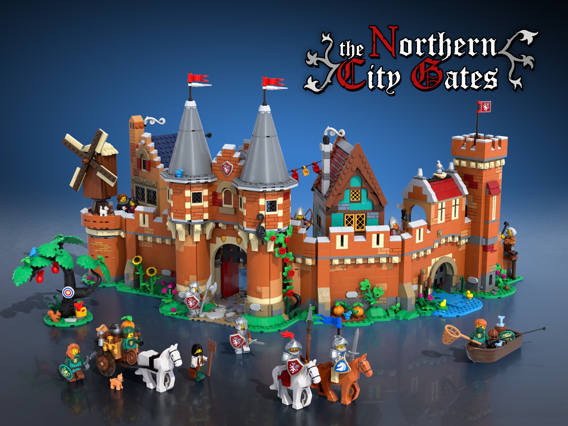

Hello there! Lucas from Bolt.Builds here, and I’m looking forward to sharing some of my design process for my first BrickLink model, ‘The Northern City Gates’. I also share more design progress on other projects on my Instagram page here. This medieval city is a hub of trade and culture. That’s not to say it doesn’t have very strong defenses, with working portcullises, high ramparts and supplies for a long siege. The Griffin Knights are manning the walls, and the Kraken faction is running all trade in town. However, roles can be reversed if they suddenly decide to attack from within!
Similar to my fan design for the LEGO Ideas Dungeons and Dragons set, I wanted to give builders many options for stories, different ways to get in and out of the space, and for characters to move around. To achieve this I designed modular walls and houses can be arranged depending on how you would prefer to display it, as a straighter wall with many facades visible, a more compact and round layout, or perhaps an S shape? It’s up to you!

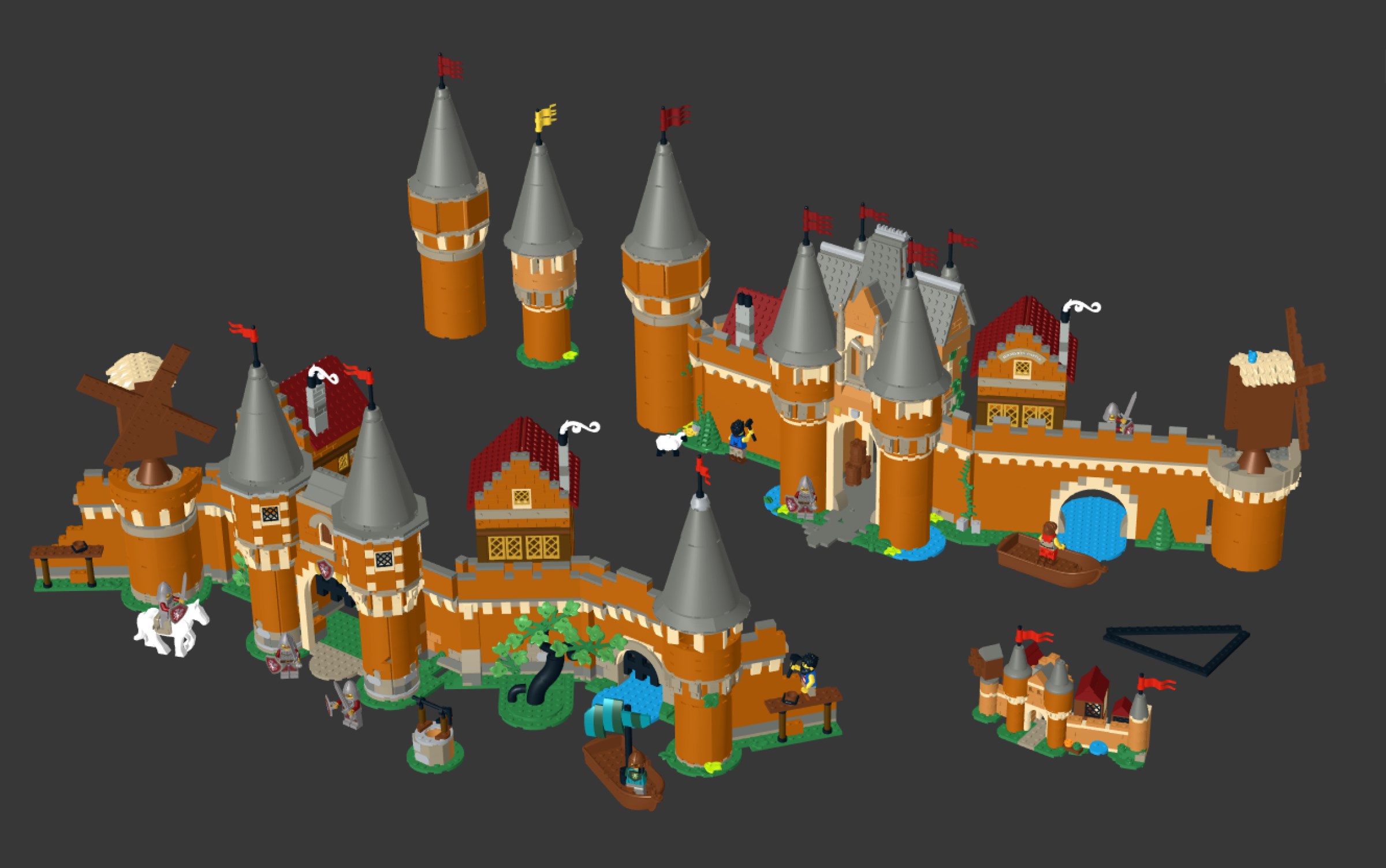

After gathering reference, I like starting my designs using miniature sketch builds that I create in BrickLink Studio. This is a great way to quickly try many different shapes, layouts, and colors, without having to create and modify a large model. It also means you can easily make copies to compare different versions, or combine sections of each version to get to your favorite design. When a design looks good in small, it will likely also look great at a larger scale with added details!

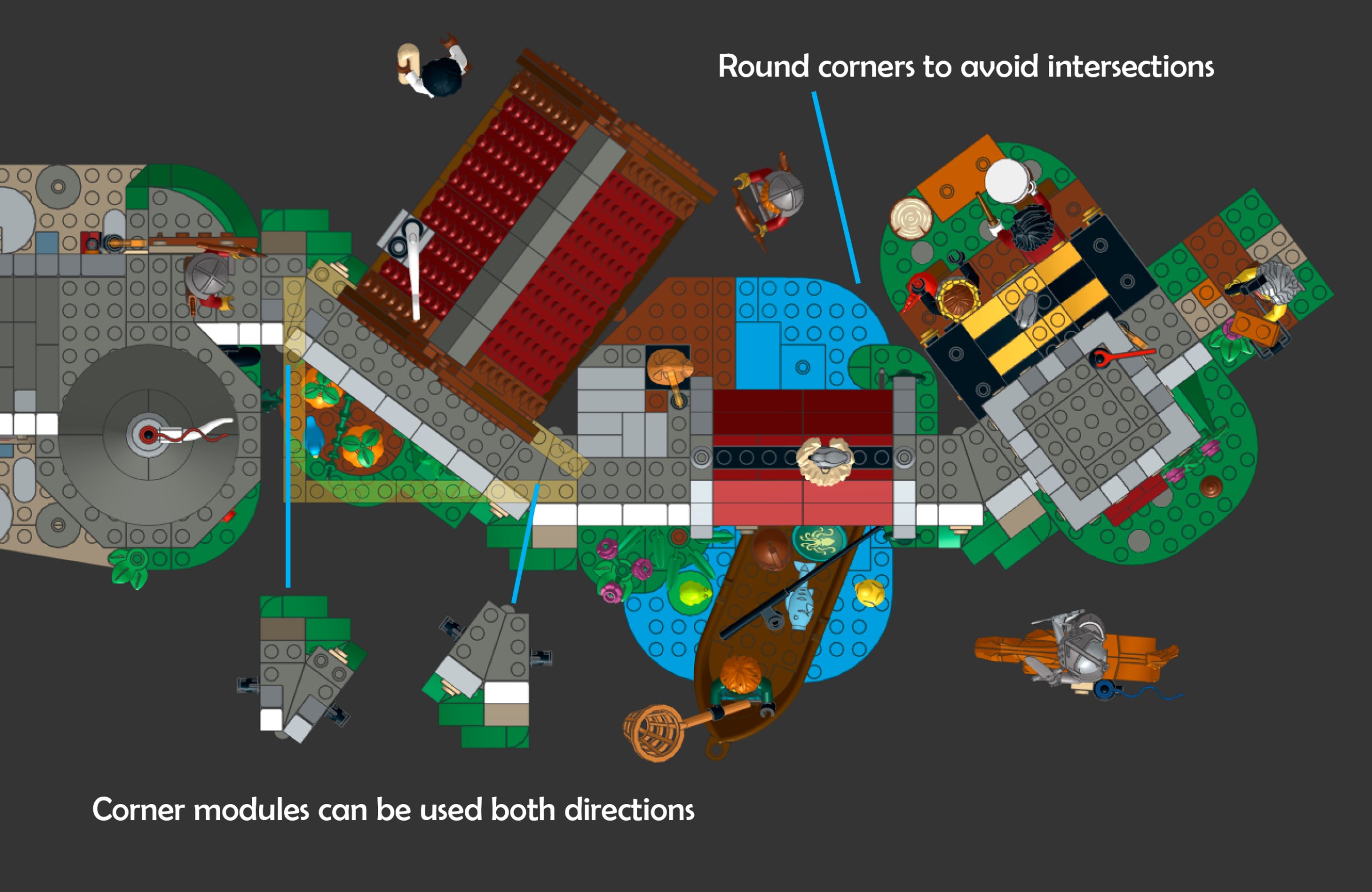

The modular city walls are an important feature of the layout, they should allow for many different setups of the city and still look organic. Ideally the corner pieces could be used in both front and back orientation so you can modify the layout even more.
I physically tested many versions of corners on different wedge plates, 2x4, 2x6, and 3x12 but the best compromise was the 2x3 wedge plate. It then became easy to flip the corner both ways, and only the top section of the wall can be easily swapped around. Also this angle avoids the attached house from intersecting with another section when they are attached to two straight sections with a corner in between.
This angle also allows for two corner sections and a straight piece to form a Pythagorean triple with lengths of 9x12x15 (multiples of 3x4x5), meaning this wall could continue ‘on-grid’ after bending back and forth.
Because this build is more a city wall instead of a castle, I decided not to make the model close fully into a circle. That would also have meant the corner pieces wouldn’t be usable in both directions, and likely have bigger gaps on opening them.

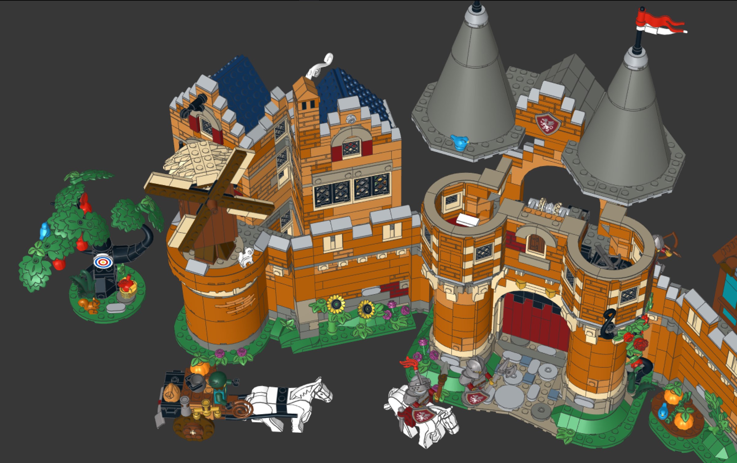

The two houses needed to fold open for play access, and at the same time the opened houses can be displayed either to suggest more facades along the wall, or to create a wider street when viewed from within.

The octagonal towers were also a fun challenge, and after many tests with cylinders I found the 1x1x2/3 slope bricks were actually perfect for this goal because they are great for 45 degree angles. It did become quite part intensive however, but it perfectly captures the shape and tan colored limestone cornerstone accents. The gatehouse roof is removable as one piece to access the interior.
Normally I build alternatives using only parts from one or two sets, so working on a Bricklink Designer Program set meant there were suddenly a huge amount of parts to choose from! Fortunately, the Palette feature in Studio makes it easy to see which parts are available in which colors, and I was certainly grateful to use that feature. Still, it’s a good idea to re-use more of the same parts efficiently to keep the number of unique pieces low where possible, while aiming for more visual impact.

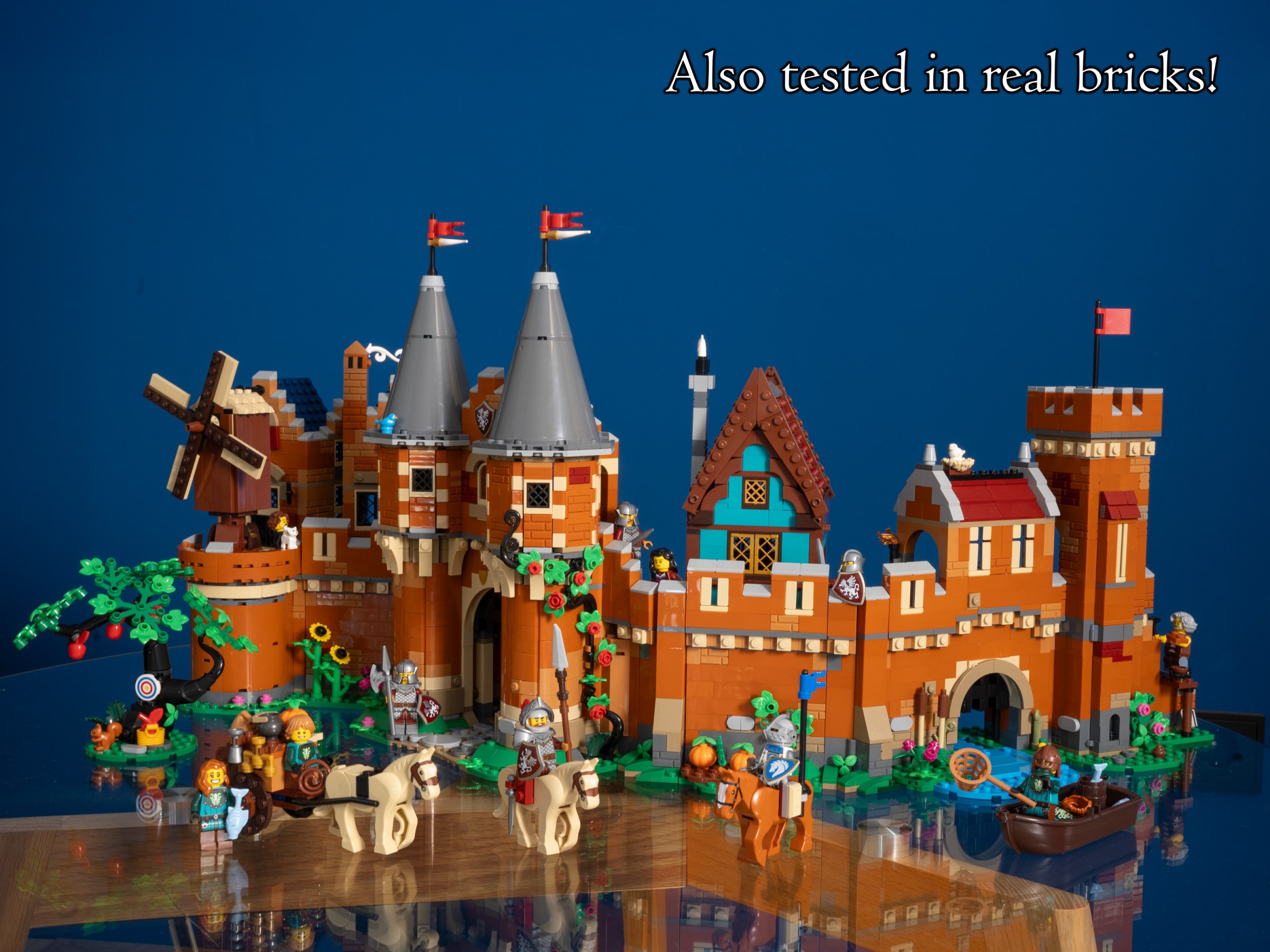

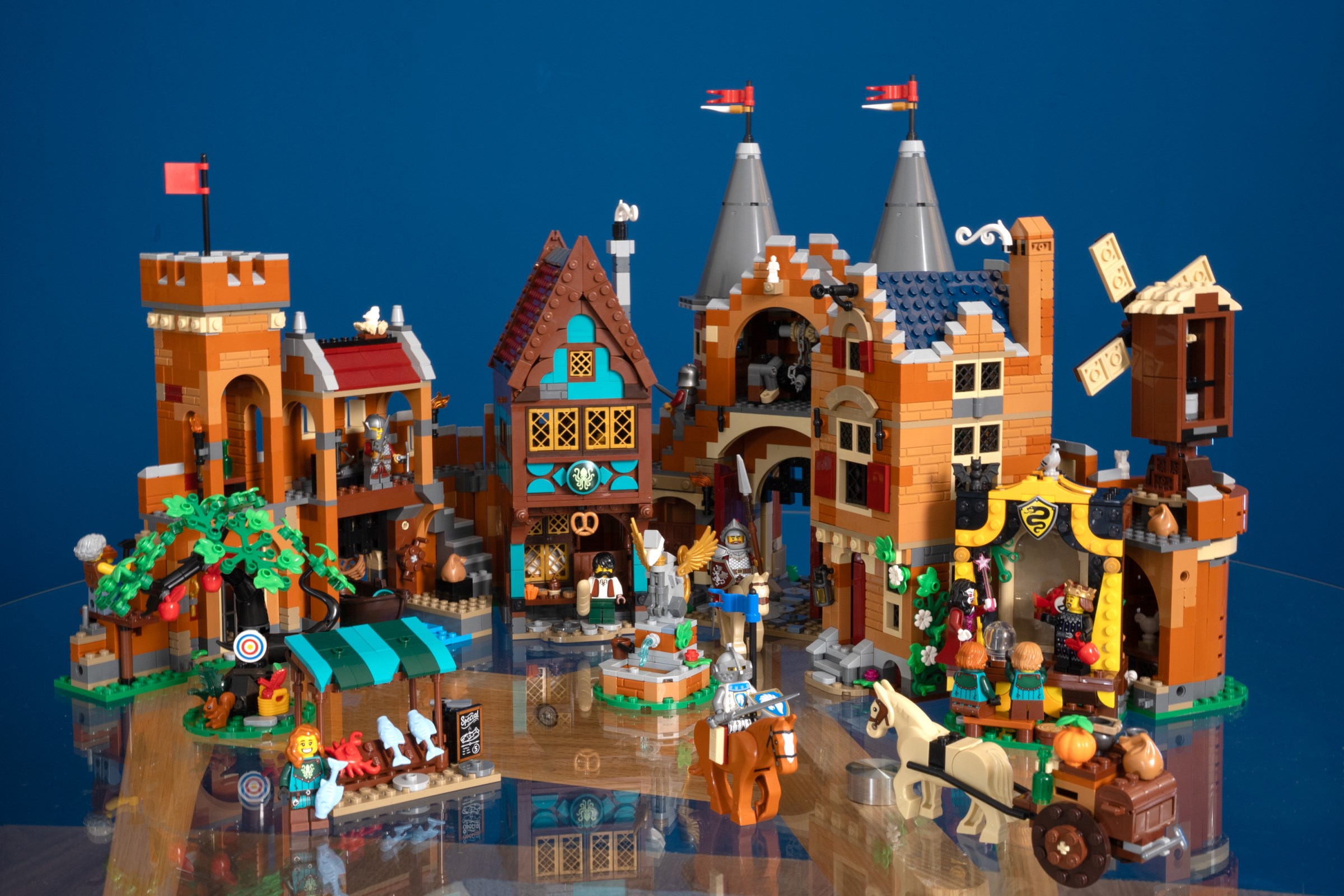

I also tested sections of the build in real bricks during development, to see how big the build would become, and to make sure the portcullises would work properly.

To test the functions and see how the model would look in person, I also ordered all the parts from BrickLink. I had lots of help from my amazing partner assembling the model in real life using the 3D model, and without her I wouldn’t have been able to bring it to Skaerbaek Fan Weekend, or to take photos and videos of the physical model. It was also just really cool to see and touch a 3D model finally in person!
