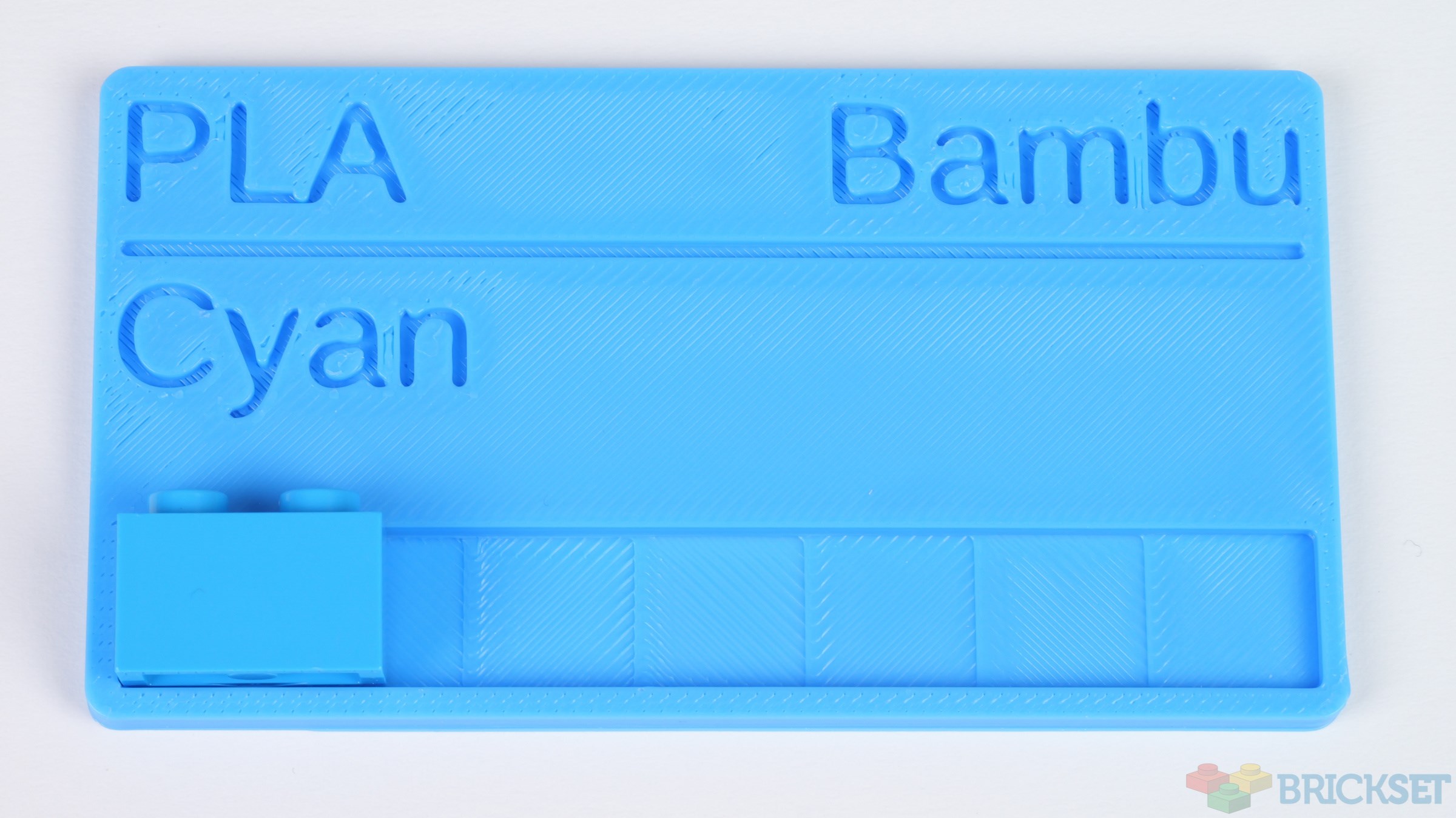

Filament seems to come in more shades of blue than any other colour and there are some good matches for LEGO blues available. Bambu Cobalt Blue exactly matches regular blue, Bambu Cyan matches dark azure, and Sunlu Sky Blue is close to medium azure.

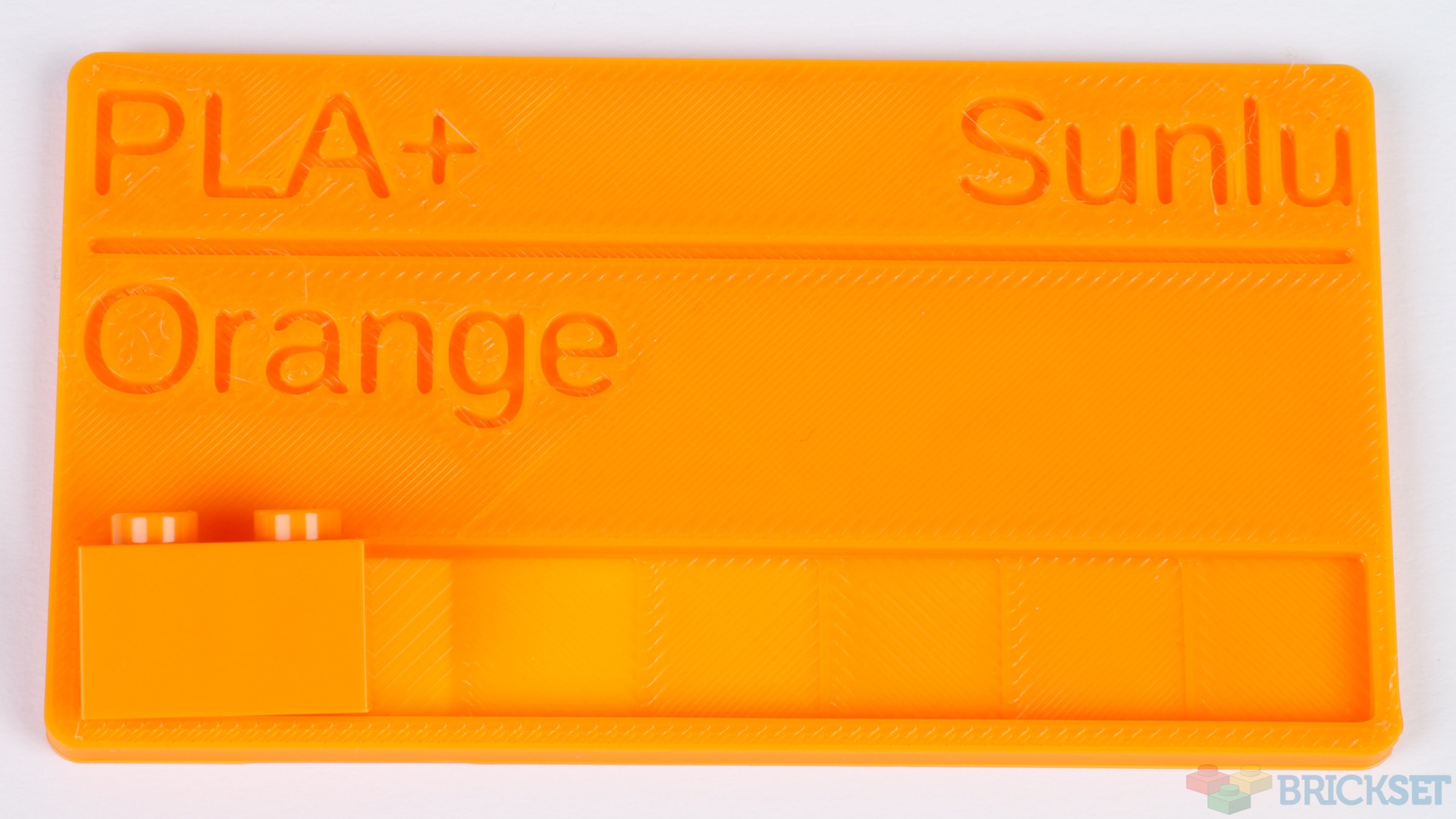

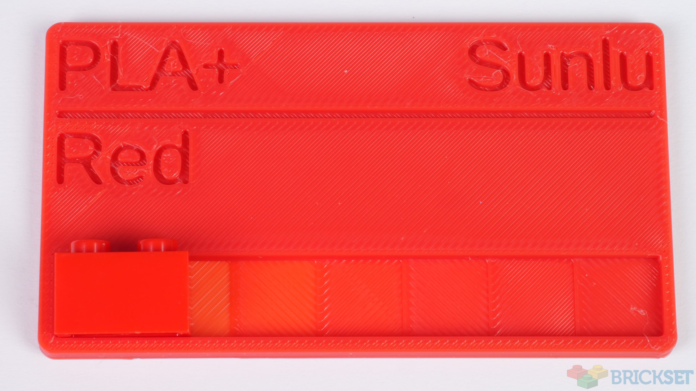

Red, orange and yellow
The red end of the spectrum is much easier to match with both Sunlu and Bambu offering colours that closely match LEGO hues.
Bambu and Sunlu reds are pretty much identical.
Sunlu orange is ever so slightly closer to LEGO orange than Bambu Pumpkin Orange.

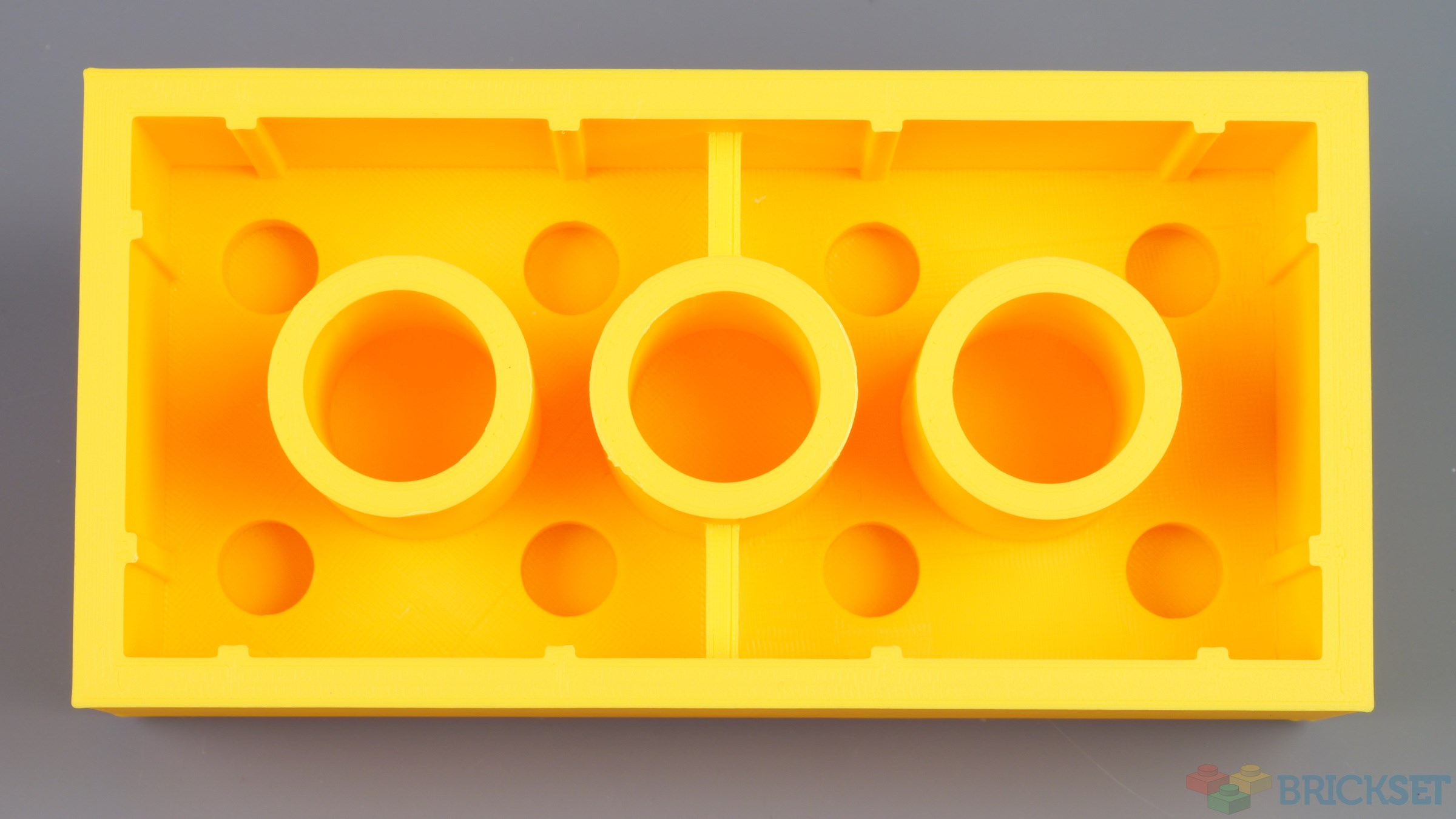

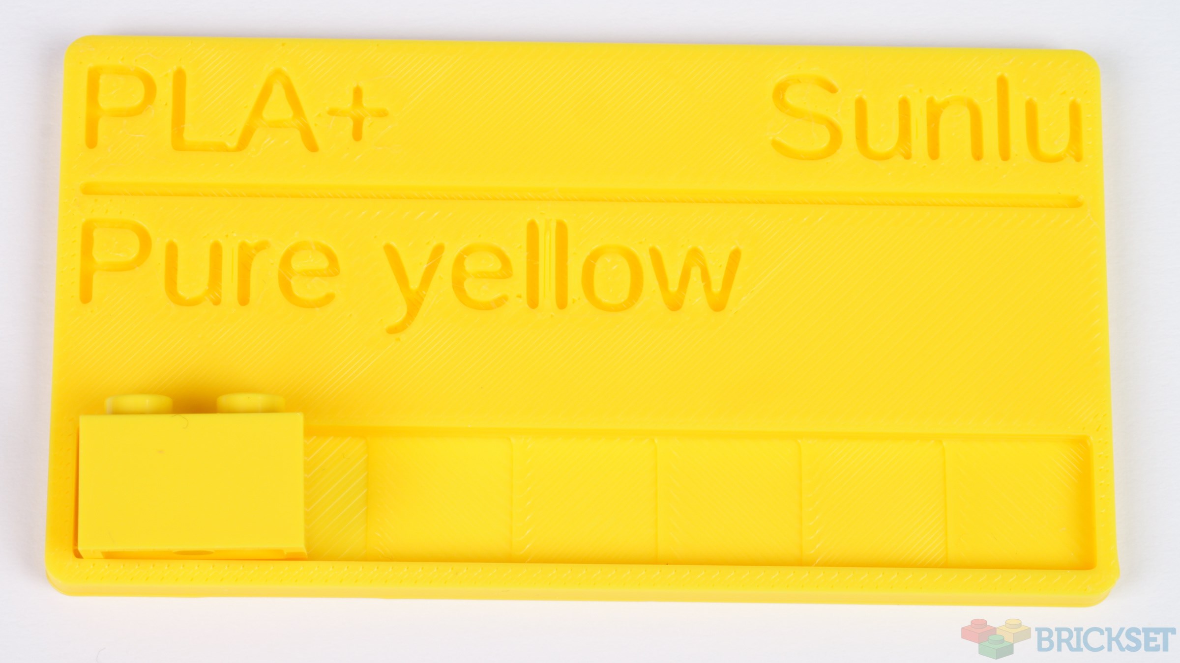

If you're printing up-scaled minifigures, you'll want to get the yellow just right. Unfortunately, it's easier said than done. Sunlu Pure Yellow is an excellent match but, unfortunately, the manufacturer keeps changing the names and colours of its filaments and that particular shade seems to have been replaced with Yellow and Vivid Yellow. 'Yellow' is a bit washed-out; Vivid Yellow is better.
Bambu Sunflower yellow is slightly too orangey but a close enough match nevertheless, and at its availability and colour consistency should be assured.

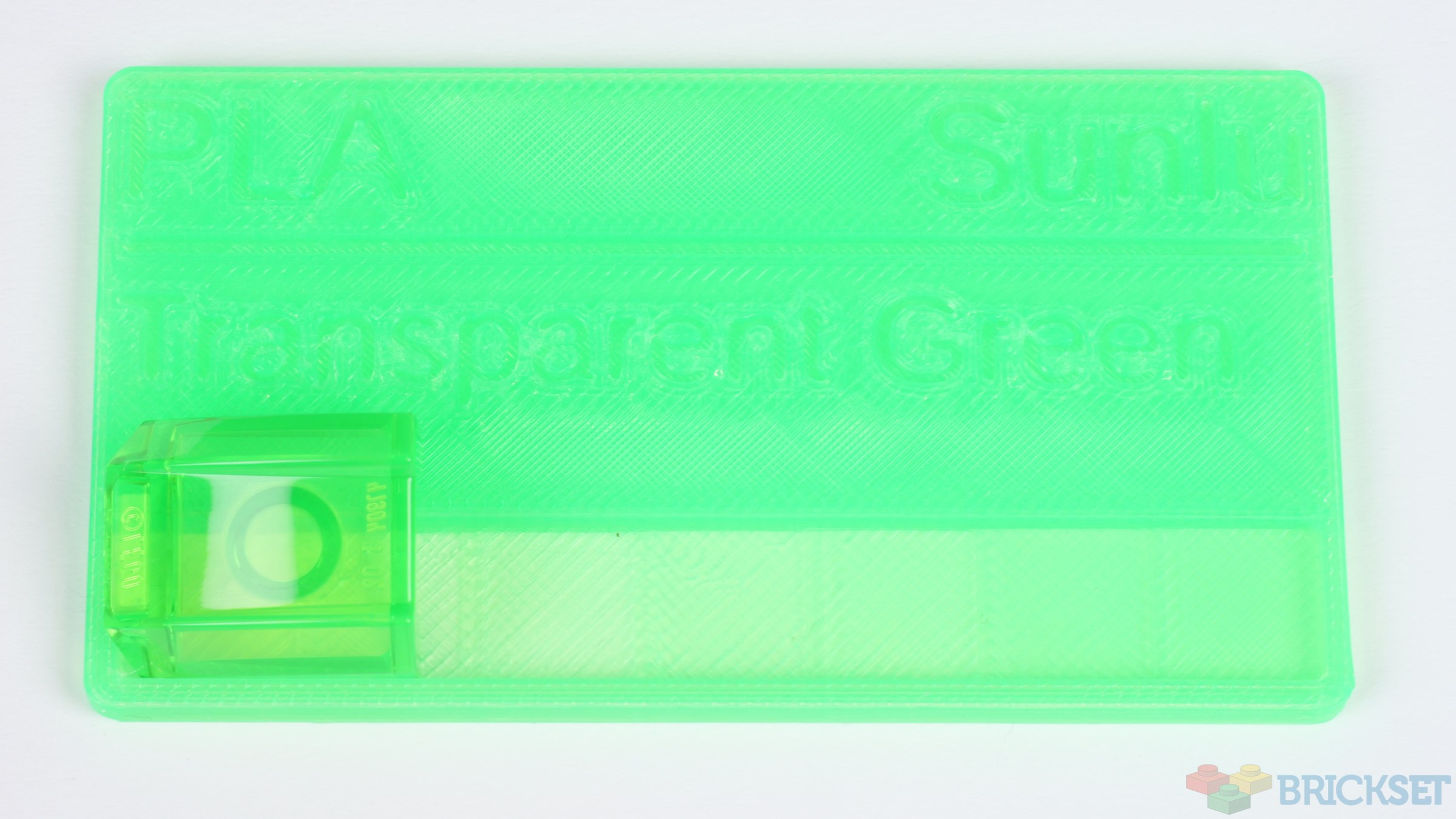

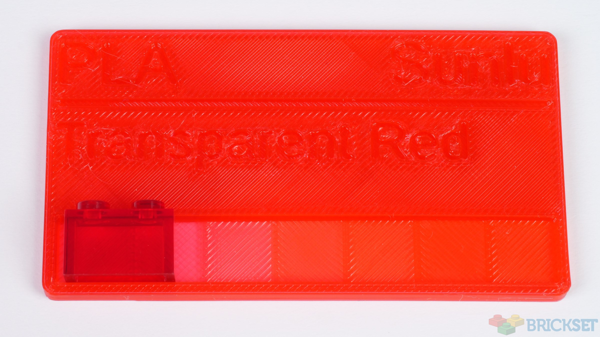

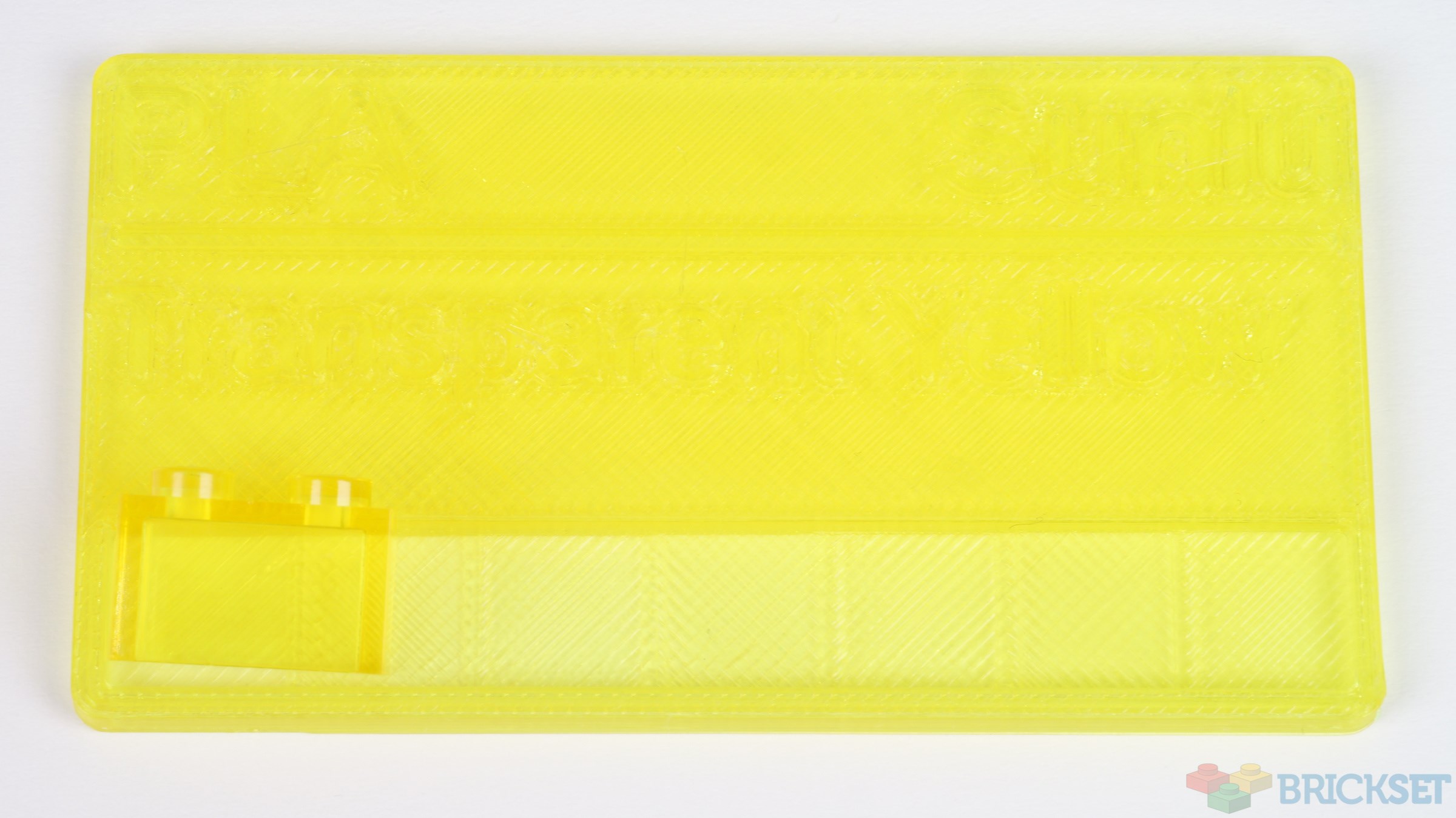

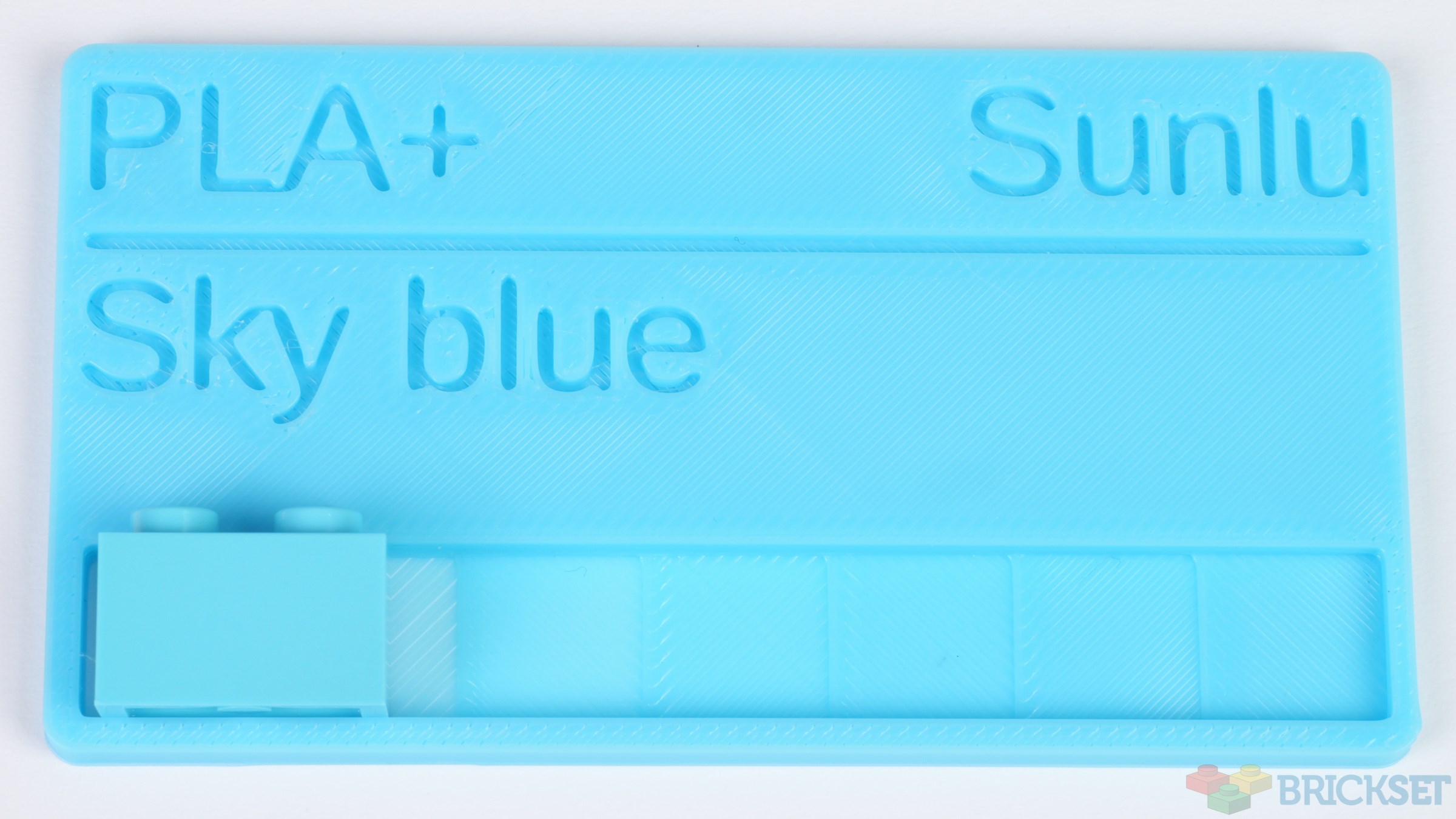

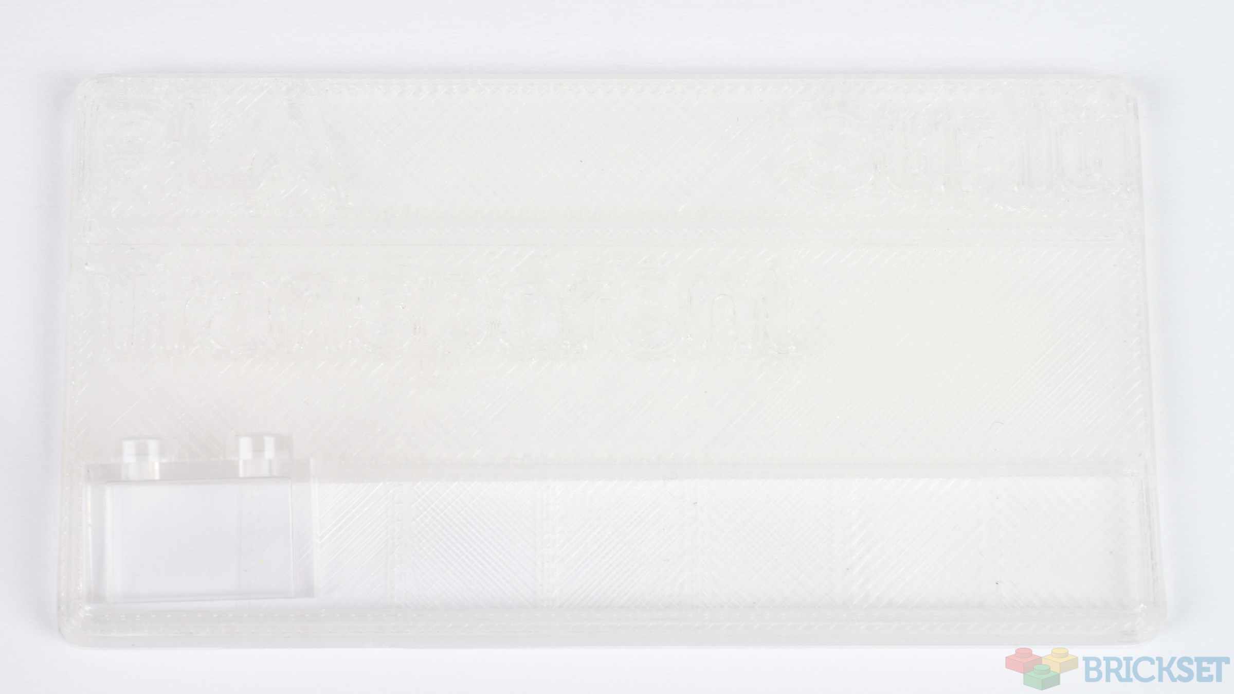

Transparent colours
Sunlu transparent red and yellow pass for LEGO transparent colours, and its green is close to transparent bright green. I've not found one that matches regular transparent green yet.

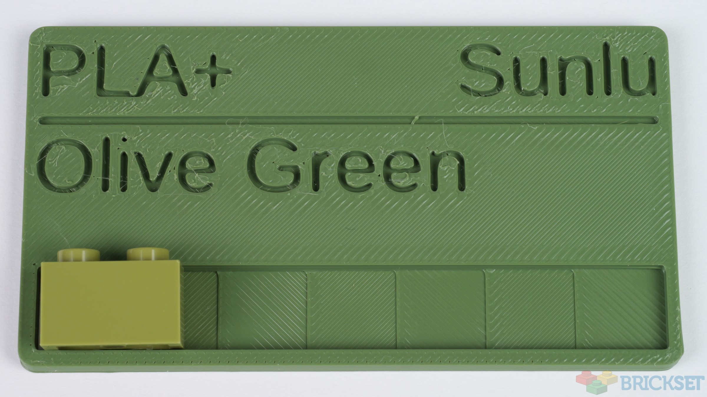

Let's say we want to match olive green, to print an upscaled Hulk bigfig or something. According to our database, its RGB value is #77774E. Searching for that at 3DFilamentProfiles shows a number of options, including Sunlu Olive Green, #636B2F, but it's not an exact match.
One way to tell if it'll be similar enough before you buy it is to use a colour comparison tool, such as the one at Colour Designer which accepts two RGB values and shows the difference in terms of a DeltaE value, which is a metric quantifying the variance between two colours. The closer it is to 0, the closer the match.
Unfortunately, the DeltaE value for LEGO olive green and Sunlu olive green is 7.53, which means the difference will be noticeable, and I can confirm that it is because I have it:
Whether it's close enough is for you to decide. In the absence of anything better, it would probably have to do.

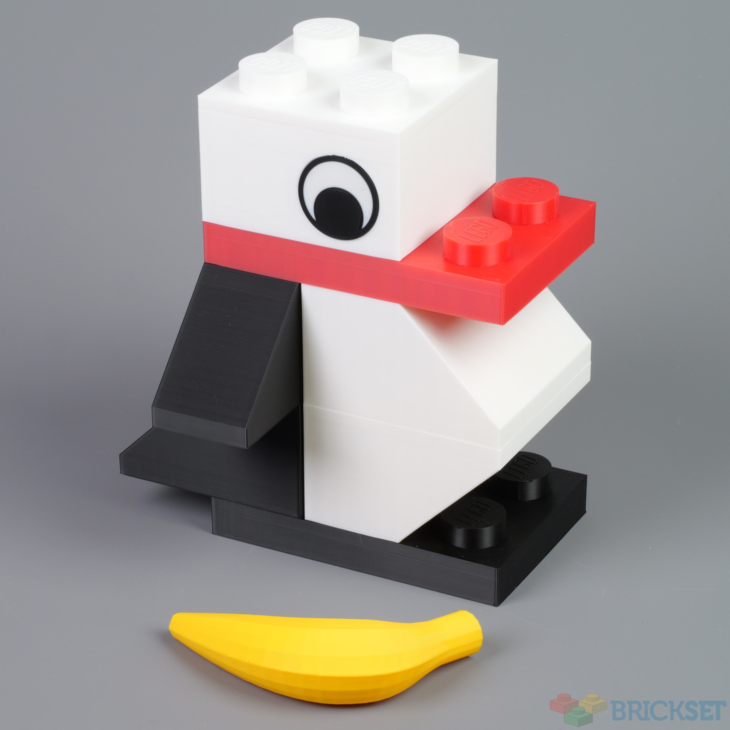

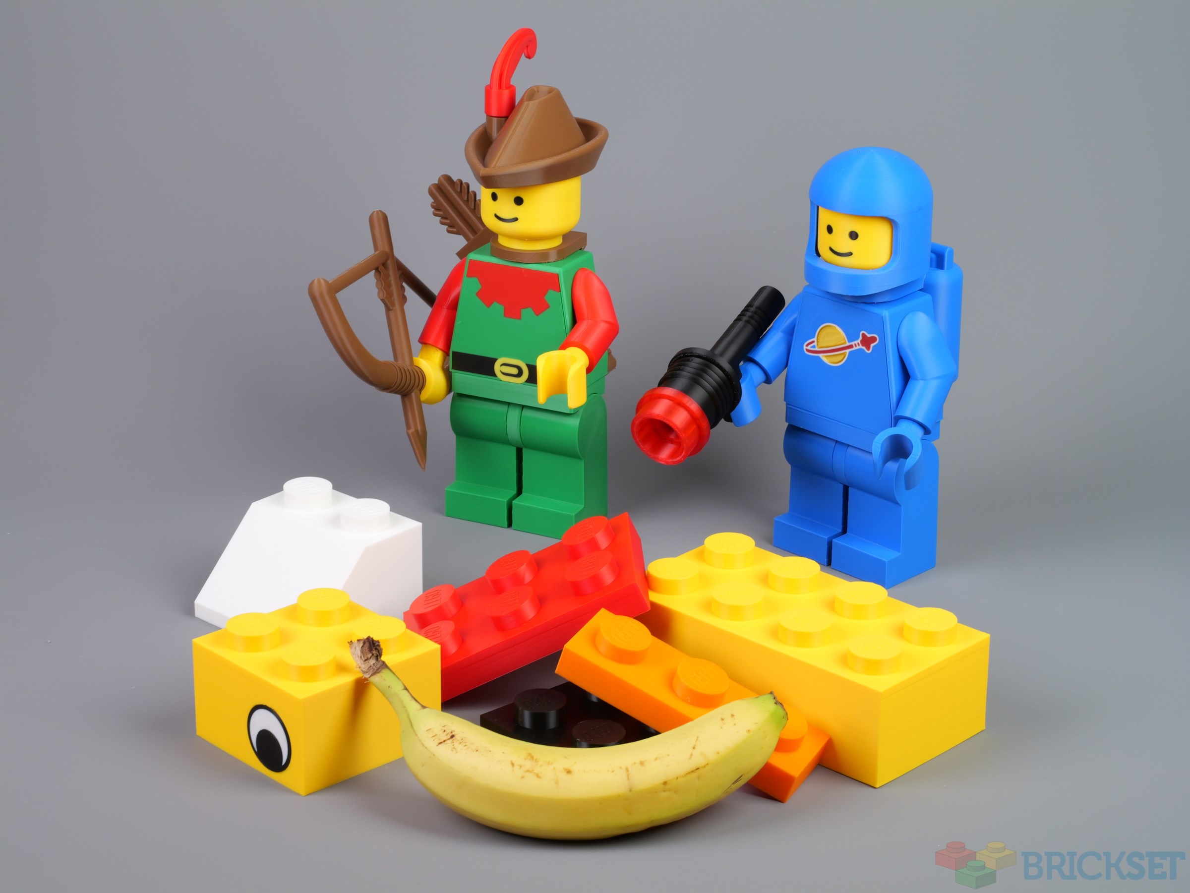

When you get the colours right, printed parts can pass for the real thing:
Banana for scale...
The photo shows 5x scale parts printed on my A1 mini which are all functional. The Forestman uses eSun brown, which is not as red as the current LEGO brown but looks to be a close match for old brown that would have been in use in the 1980s when the figure was produced. Unfortunately, I don't have any bricks in that colour any more to compare it with.

Wait so are those articulating giant minifigures? I suddenly want to get into the 3D printing craze…
@LukeSkywalker said:
"Wait so are those articulating giant minifigures? I suddenly want to get into the 3D printing craze…"
Yes they articulate in all the right places, so can be posed as you like, but the joints are much stiffer.

I was looking for a good match for Lego blue and was thinking about trying out Bambu's cobalt blue, so I am happy to see it is such a great match.

" @Huw , naive question, but are the details such as the smiley faces printed on at the end? Or are they layers of different coloured plastic that go all the way through the model? "
The smiley faces are 'layers of different coloured plastic that go all the way through the model'. As each layer is printed the printer prints the yellow bit, changes to black, prints the black bit, prints the black bit on the next layer, changes to yellow, and so on. It produces a lot of purge waste to ensure no colour bleeding but the results are excellent.
The fronts of the torsos are printed face down then glued on to minimise that."

@Huw, How did you grow that teeny tiny banana?
