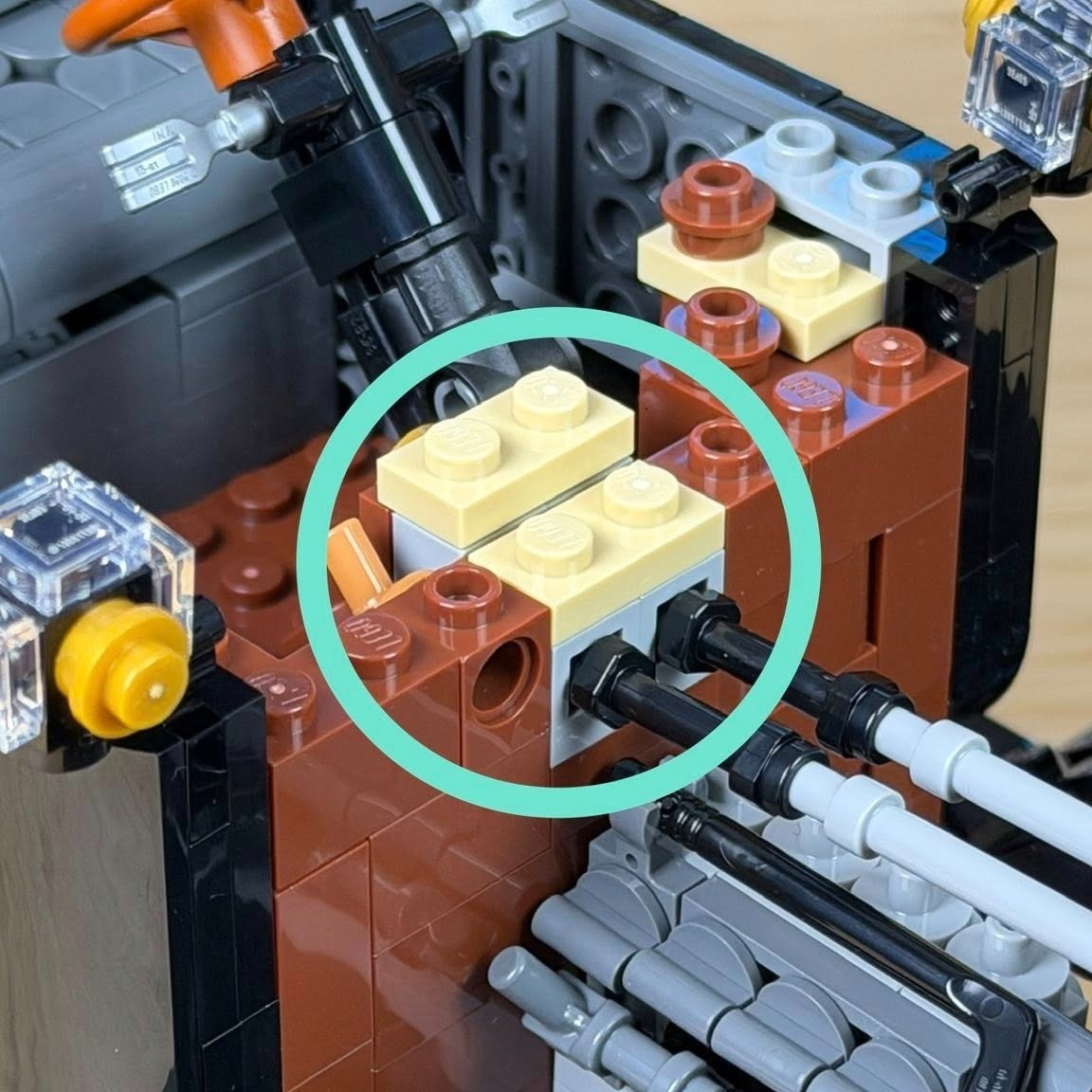

Unfortunately, he found a serious illegal technique that is stressing elements to breaking point.

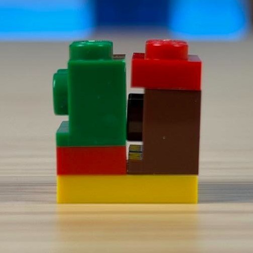

The problem he found is caused by the fact that stud on the side of a headlight brick sticks out further than the width of a brick. Consequently, they can't be placed next to another element with the stud facing in, but that's exactly what's been done in the Model T.
Here's a small construction Tiago built to illustrate the problem. The stud of the brown brick interferes with the back of the green one, so it won't affix properly to the yellow plate below it.
At best it's unsightly, and you would not expect to find the technique used in an official model, but there's no real harm done to any of the pieces.
The real problem comes when you attach a plate above them and that's exactly what's been done on this model.
We are led to believe that models undergo stringent quality tests to ensure that they can be built, are stable, and do not include techniques that might cause pieces to break over time, so one has to wonder how this ever passed review.

It's especially puzzling that this illegal technique was used in the first place, because I can't see any reason not to have the other headlight bricks placed one plate lower, which would resolve the issue.
Wonder why they didn't use the technic brick with the two pin holes? Actually something is tickling the back of my head that it is also illegal in some fashion, like I know you aren't supposed to mate those with stud out bricks. Can anyone confirm that's the case?
Couldn't they have used a Technic brick instead? And yes, I am awar that the hole in those is slightly higher than in the headlight brick, but considering the pieces it's used for here I'd think there's no stress in that connection? Or at least a lot less than with this method.

You are free to use illegal techniques all you want, but LEGO (usually) doesn't because it breaks / bends parts, which drives up consumer complaints and part replacement requests plus it gives the company a black eye to the public when things like this surface. These 'legal / illegal' rules have changed slightly over time as the parts catalog and design ideals evolve. (Example: The sideways-plate-wedged-between-the-studs of 1970s sets wouldn't fly today. Tiles, however are fine like that, but studded plates are not, as they as slightly thicker in width due to the LEGO logo on the studs) So this error - and others like it - is a big deal, and it's very odd it passed muster with the issues it has.

It's always interesting when these things crop up. What's surprising here is that the illegal technique is such a basic, obvious one - even 8-year-old me knew headlight bricks didn't fit together like that. How did the designer not notice it? (And digital designs aren't an excuse: LDD wouldn't let you place headlight bricks like that.)
Some other questions come to mind: why not use 1x1 Technic bricks there? It's not illegal to attach individual studs to Technic holes. Why don't the parts look stressed in the in-situ photo of the set shown in the article? Finally, are we sure Tiago built the set correctly? Not that I doubt him, but I can't view the instructions, so we technically don't know for sure that this issue is legitimate and not user error.

Worse, this is one of the specific instances cited in the Stressing the Elements presentation that first introduced AFOLs to this concept, so it’s been a known problem for decades at this point.
@lost_scotsman:
If you attach a brick/plate/tile to the side of a Technic brick in any manner, you can’t also attach overhanging elements to the top of the Technic brick, because the top piece can’t be fully seated on the Technic brick. You also can’t put the studs of x2 or longer parts into the Technic holes because the clutch is stronger than a normal anti-stud connection, and it’s too difficult for kids to disassemble. The Monkie Kid hilts avoid both of those problems, plus the bar extending outward would make it super easy to pop them loose when needed. However, I can’t recall the last time I’ve seen even a 1x1 stud inserted into a Technic hole.
