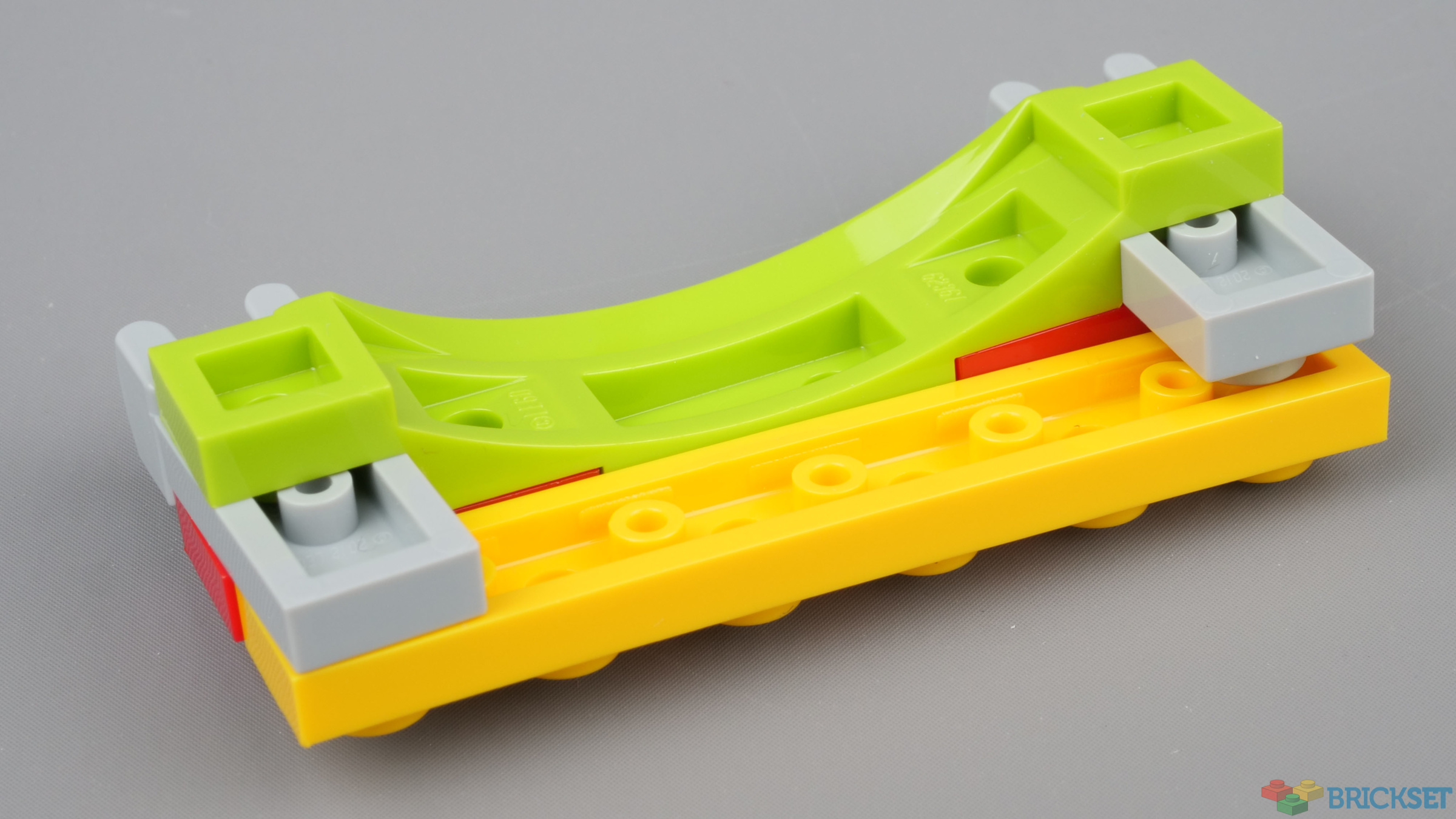

At first glance the assembly below, part of the creature's lower eyelid, looks innocuous, but closer inspection reveals what could be a design flaw.
Here's the assembly made with different coloured parts for clarity.

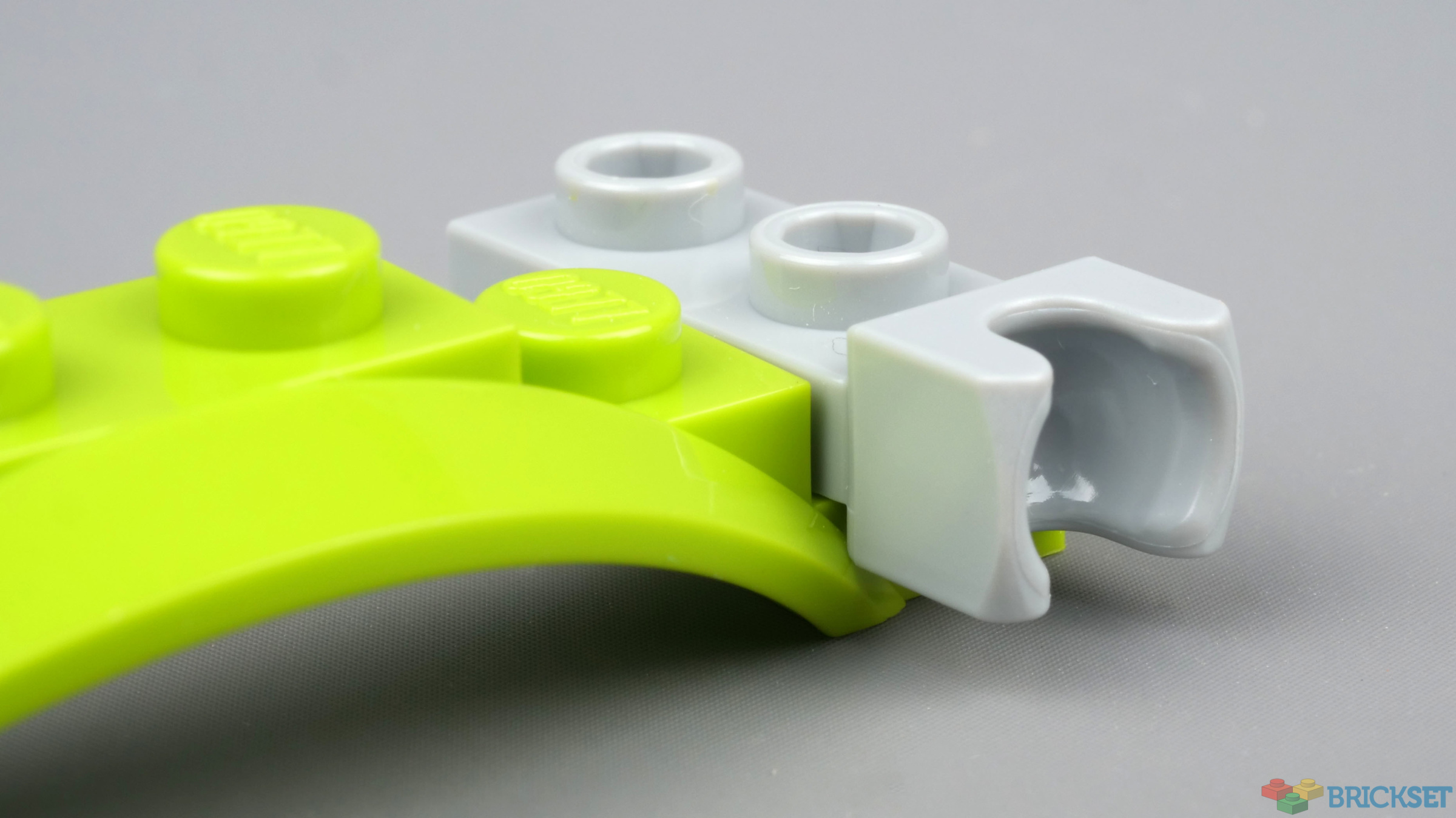

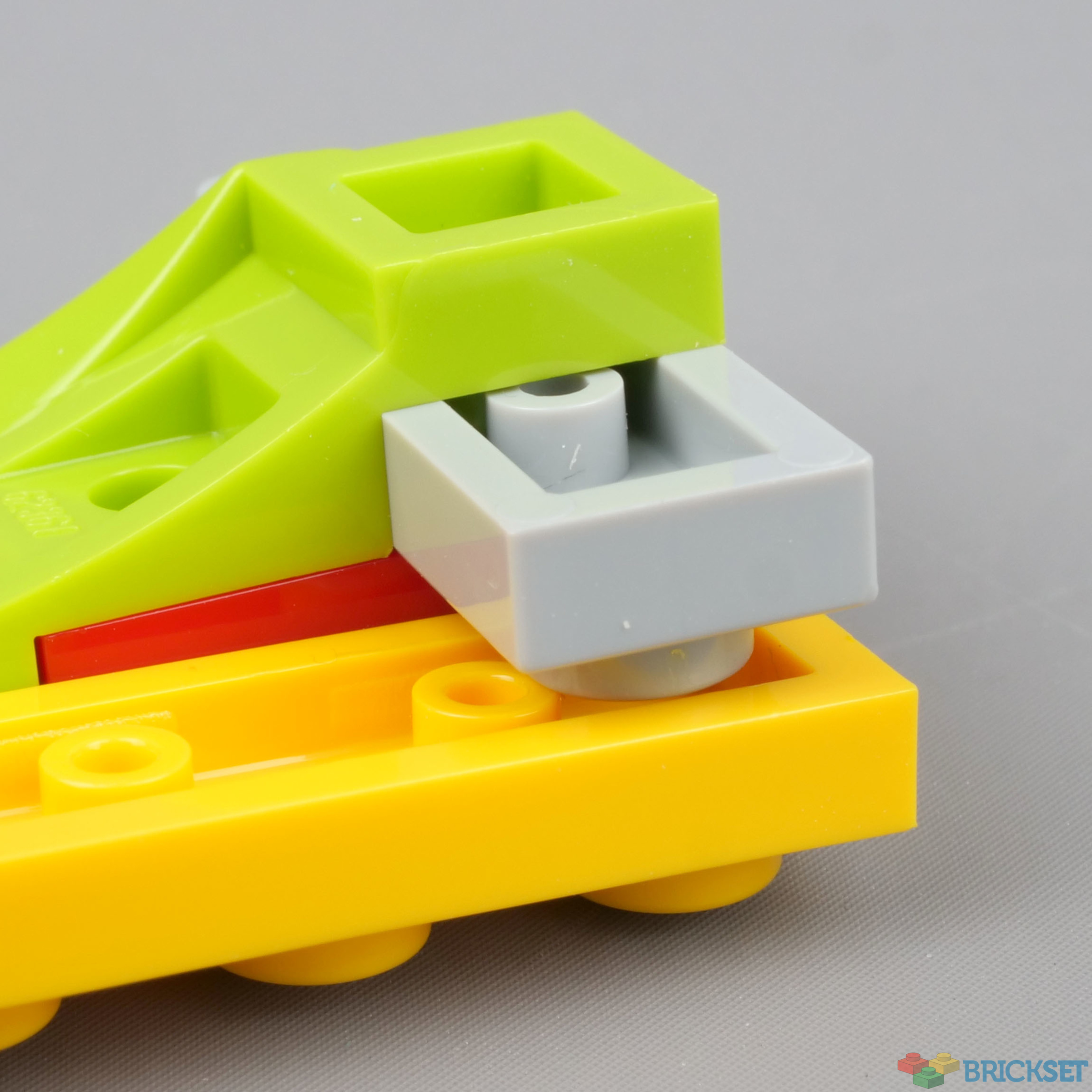

The issue arises because the grey ball joint sockets, 14418 PLATE 1X2 BALL CUP / FRICTION END, cannot be affixed at right-angles to the lime green 62361 SCREEN 1X6X1 W. EDGE because they interfere with its arch.
As you can see, the bottom corner of the socket is in contact with the arch preventing it from being twisted round any further.

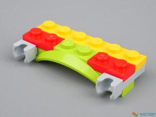

The 1x2 plates in step 18 of the instructions above can be attached to the top to hold the pieces together, but of course the sockets remain at a noticeable angle.
The problem manifests itself when you attempt to attach the 1x6 plate at the back.
Because the grey pieces are splayed inwards slightly the stud of one of them does not align with the stud receptor on the bottom of the 1x6 plate.
It can be forced, but as you can see the parts are still at odd angles, and the pieces do not connect flushly.

@PurpleDave, I doubt that shaving a few microns from a corner is going to compromise the socket’s structural integrity or functionality. If it were along the mould line, sure. But not there; it’s sufficiently far from anything important.
I hate how quite a few of LEGO's recent products have been problematic. I understand that thse have been trying times for the world, but really? Even sites like Brickvault require their model designers to build basic models of their designs IRL to ensure that there are no structure issues.
I noticed too in the recent years the quality concerns of Lego sets, in terms of the rigidity of the plastics, I had some broken pieces recently and some of the colors can be a little bit off (but not a lot, thus it's not at an alarming level, however given the pricing of sets I'd hope that they can be perfect). And the issue that is brought up here, to me it is an absolute no go. Was there ever a QA team doing the necessary job to build and check for all the details before releasing it? The issue with AT-AT is more forgiving in my opinion (given the fact that it is more at the dismantling stage). Thanks for sharing these information too, Brickset should be and can be an unbias Lego journalism, I fully supports it. In fact rather, I'd also like to see more contents regarding: re-building, educational how-to, or interesting building techniques on this site (but maybe that is not the main focus of this site anyway, and not the main focus of Lego).
@DavidBrick said:
" @beckersfuzzy said:
"I don't see what all the fuss is about.
Just file the offending parts down so they will fit (issue resolved)still original parts .
I do not get into the Lego purist stuff ,once it is yours (purchased) do what you like, not be dictated by others, as they have their own set to fix in their own way!"
If I need to file an insanely overpriced LEGO toy why should bother buying it? Why not by MegaBloks (or whatever they call themselves)?"
its mega-construx, and their quality these days is way better then lego's....just saying:)
