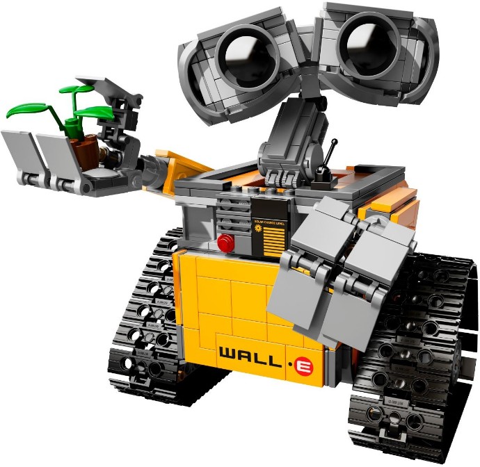

The release of 21303 WALL•E has been fraught with difficulty after a product recall in North America and plenty of debate about the structural integrity of the neck joint. I had assumed that any such problems were now resolved.
However, it appears that they persist as we have learnt from a reliable source that the set has been recalled from LEGO Brand Retail Stores in the UK. The precise reasoning behind this action is currently unclear, although it is presumably a result of the familiar clutch issue involving the click hinges at the base of the neck.

I bought one after the first recall. The Up/Down motion of the neck is good, but now it swivels freely. I ended up cutting a small piece off a bar and pressing it into the end of the technic connector. Works great now. Everything is friction motion and I can position his head however I want. They might be replacing the blue technic connector with a tan one for the extra friction.
What, seriously?? I bought one of the originals (Europe was unaffected by the floppy up-down hinge joint in the neck), the only problem was that the head freely spins 360 degrees and won't stay posed. If Lego redesign that joint then great, so long as a parts pack is issued. But what on earth is going on with Lego's quality control?

My frustration is there's no word after all this time from Lego on what their action is in response to this fault after recalling it a second time. It seems that replacing the joint parts are not solving the issue. Plus the freely swivelling head has not been acknowledged by Lego.
Haven't had any issues with titling the head on the vertical axis, but did encounter the free spinning head on the horizontal. Called LEGO Customer Service about it this past Friday and they said they would send me a kit containing four pieces to resolve the freely spinning head issue and that it would take 7-10 days to receive the parts as they are picked out of their warehouse in Denmark. Other than this and a few styling issues, I'm happy with the set and happy to have it in my collection.

I ended up doing Chris McVeighs neck fix. I went to the Lego site and filled out the missing bricks section for all 21 pieces and even though i expected them to cancel the order it went through. I got sent out all the parts for free.
Now my Wall-E has a great poseable head.

@tecjam @Sly Raskal My WALLE direct from Lego's web shop has the loosely spinning head problem. Have emailed to complain. Will see what they say. Failing that I guess I'll try and get Chris' bits for free as @leerock suggests :-)
In the mean time wrapping the top of the black pin in ~2 layers of cellotape gives it enough friction.

When I get it, I will be using @jljohnson814's solution and shall be sticking a bar in the neck pin to add some friction.
This is the response I got from asking about the free spinning neck -
Dear Richard,
Thanks for getting in touch with us.
I’m sorry you’re having concerns about your LEGO® Ideas 21303 WALL•E set. Only the American version had an issue where replacement parts were sent to affected models. The stock here is made in our European warehouse, so is not affected in the same way as the USA model.
Like you, we’re big fans of this courageous little robot and we’ve designed LEGO WALL•E to be as close to the movie character as possible. As you may know WALL•E can turn his head 360 degrees and swivel quickly and easily – that’s why he’s so good at whizzing around the planet and spotting rubbish to collect.
When you build LEGO WALL•E, you’ll find that the bricks we’ve chosen let him turn his head 360 degrees. This does mean that his head moves quite freely and you might not be able to duplicate all of the poses from the film. We take a lot of care when choosing our bricks to make the best sets possible and we hope you still enjoy the building experience. The design had been checked through and approved by the quality department and our partner Disney. Also due to the“ heavy head” of Wall-E – in some poses of the head the neck will not be able to hold the pose.
I hope that helps to explain how the Wall E model is supposed to work. Listening to what LEGO fans have to say helps us get better and better so I’m passing your feedback on to our designers.
If you have any further questions, or you feel you need extra pieces to make it work, please do let us know, we're happy to help!
^So... in other words... neckgate was intentional? Come on, now, LEGO! "might not be able to replicate all the poses from the film," my foot. He can't pose at all!
