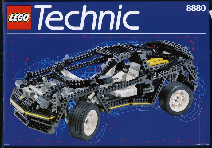

For many Technic AFOL enthusiasts, 8880 Super Car marks the pinnacle of what can be achieved with completely brick-built Technic engineering. This set is the flagship Technic set for 1994 and has gone into Technic lore of what can be achieved with good engineering using the original brick-built techniques.
Read on to see how LEGO designed Technic brick-built sets in the 1990s. See how this set incorporated four wheel drive and four wheel steering features, while also having the distinction of being the first Technic set with a V8 engine.
Box/Instructions
As with all significant Technic sets, 8880 Super Car comes in a large box. The front of the box has a great image of the car superimposed over a 1:1 scale profile.
8880c
As you can see, my box has seen better days.
