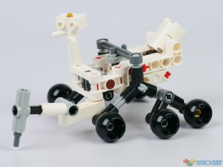

It's surprising just how accurate and functional this tiny little 83-piece model is, incorporating many of the features of its larger cousin, 42158 NASA Mars Rover Perseverance.
The vehicle's sophisticated suspension system has been replicated here and works as it should, with all six wheels on the ground, even when encountering Martian rocks.
The two sides are linked together to provide stability. The rod between them is held in place by an unorthodox but effective method, sandwiched between two bars.
The only thing wrong with it compared to the prototype is that the wheels should be inline, but the centre one sticks out. Excusable given the scale of the model, I think.
The front probe arm can be rotated to its operating position by twisting the axle joiner on the right.
I do like the Technic polybags that have been released recently and this is certainly one of the best: recognisable and functional, more so than some of the larger models!

Just an FYI regarding the middle wheel placement, these wheels stick out on the real rovers too, both Perseverance and Curiosity.

With that 3D view, it's possible to line the wheels up where you can see that the centerline of the outer wheels still falls within the box defined by the corner wheels. This is not the case with the polybag build, where the wheels are less than two modules in width, part of that width is the offset hub, and the center wheels are a full module farther from the chassis. Keeping them in line with each other might have actually been more accurate to the real thing. While the basic configuration of the suspension arms is accurate when viewed from the side, the front and rear arms actually angle out from the chassis. This is something that would not be achievable in such a small scale, and shifting the center wheels in to a more accurate position would have required a significant deviation from the basic design of the suspension arms. It still looks weird how far the center wheels stick out.

Let's not exaggerate on the exact proportions of this tiny build. It looks pretty good to me considering the min. thickness in Technic is 1/2 M. https://i.imgur.com/NMKX6AW.png
So better to include this detail (and especially the rocker-bogie suspension) than to make all 6 wheels equal like they did in the large set with the wobbly wheel arms.
Does the suspension system really work as it should, when getting over that brick? I can see it overcoming a height of one plate thickness at once but surely when the wheel comes up against a brick it just stops as it is taller than the wheel is high.

Unfortunately, the specific design of the suspension arms is such that the center wheels are prone to tucking under and lifting the rear wheels clear of the surface. Fortunately, when this happens, it becomes a pretty standard 4-wheeled vehicle, as the offset mount for the rear wheels locks the rear suspension arms from rotating up more than ~90 degrees.

No, it wont traverse obstacles like that by itself, and neither will the larger one, partly because the wheels have no grip.

Keep in mind that on the real thing all wheels are powered, which would have a much different effect then when pushing the wheel against an obstacle. The real thing should be able to pull itself onto a taller obstacle at least to some degree. So while the suspension is probably quite accurate, it just doesn't work as well like this.
@WizardOfOss:
The 6-wheel suspension is designed to handle uneven terrain, not mount boulders. When they're sending commands, they have to plot as smooth a path as possible, since there's no such thing as real-time control here.
The rocker bogie suspension is pretty counter-intuitive unless you know what the intention of it is supposed to be. At its very core, instead of keeping the vehicle platform as level as possible at speed like you would expect in a conventional car that we use on Earth, the design is supposed to cause the platform to angle upwards at 50% of the total difference in height between the left and right wheels.
That's why they're connected by that swiveling rocker arm that goes over the body of the chassis. When the front wheel on one side encounters an obstacle, it drives up and over it, while the suspension arms twist the entire geometry. That gets transferred across to the other side, and manifests as a tilt in the body of the rover. The real rover is designed to handle a 45-degree angle between the wheels, but the software is designed to limit it to 30 degrees (in real terms a 15 degree tilt on the rover).
There are no springs or dampers to control vertical movement, as they would want to find equilibrium over both sides and cause large angles of tilt. The rover moves so slowly that a bump doesn't cause the rover to bounce uncontrollably, so it's not useful here. It's just a way to allow the rover to cross uneven terrain without upsetting it too much, while also letting it cross foot-tall boulders with minimal stress. When you think about it, it's more similar to watching an animal walk over uneven terrain.
