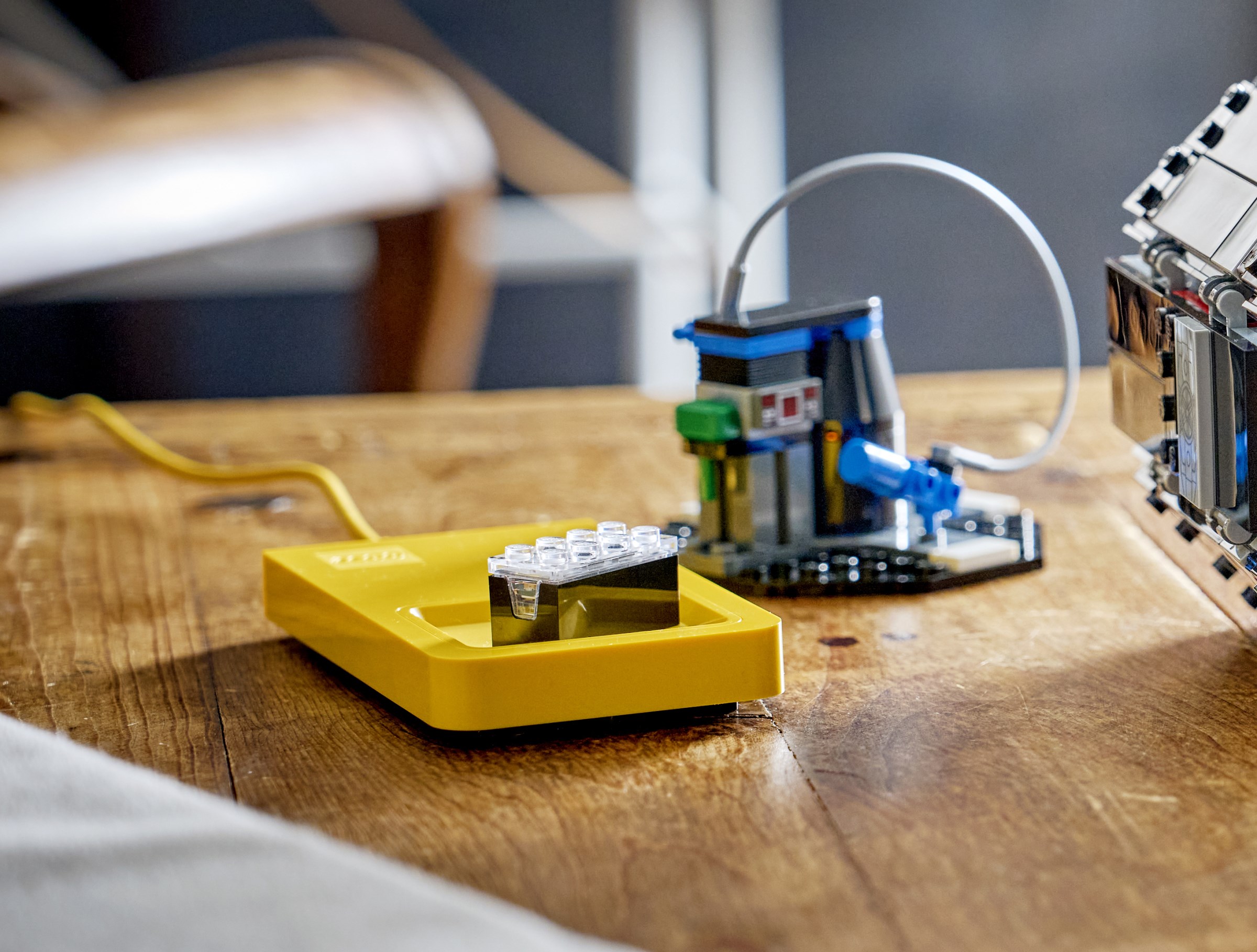

Battery Life and Charging Time
Each set containing a SMART Brick also includes a charging pad with space for two bricks. They take about two hours to charge fully from empty and the charge should last for about 45 minutes of extremely thorough use, with lights and sounds happening all the time.
Also, the brick is designed to retain battery life out of the box, so children will not have to wait for it to charge after building the set, which would obviously be a major problem. The brick turns on when shaken, which could happen during transit before the set has even been purchased.

For comparison, Switch 2 can have as little as 2 hours battery on a full charge. But at least you can continue to play that while it is plugged in.

So, two bricks per charger, and a 2-hour charge cycle, but you only get 45 minutes out of each brick before it needs to be recharged. So, mandatory half hour break for every two hours of use?

@PurpleDave said:"So, two bricks per charger, and a 2-hour charge cycle, but you only get 45 minutes out of each brick before it needs to be recharged. So, mandatory half hour break for every two hours of use?"
The article said "extremely thorough use." Kids probably aren't going to have it lighting up and making sound for forty-five minutes straight.

@LachlanA said:"The only complaint I have is that the charging pads are in every set. I feel like I might end up with a few.
But otherwise I'm excited! These look so interesting!"
Better to end up with a few because they're in every set then have to buy a set you're not interested in because that's the only way to get a charger.
For the sanity of the parents.

@LachlanA said:
"The only complaint I have is that the charging pads are in every set. I feel like I might end up with a few."
You can feel better about the ecological impact if you wrap the extra charging pads inside Lego's new non-recyclable plastic-infused "paper" bags before you throw them away. At least they will head to the landfill in the greenest of all possible packaging.

The pads are in every set that comes with a Smart Brick. So far, that's three sets that yield a total of at least four bricks (the lightsaber duel obviously comes with two). You'd need a 2:1 or lower ratio to keep every brick charged between uses. If you really want to go gangbusters, you'd need a 3:1 ratio for every model you want to equip with a brick, so you can have two waiting in the wings (this would get agonizingly tedious if you went all in with a public display).
Presumably, there could be less expensive sets later on that only include the chipped elements, but no bricks. This would be more likely to happen with chipped minifigs than chipped models, since the chipped tiles built into models appear to all be set up for the brick to be semi-permanently installed on top of them. Heck, it wouldn't surprise me if they plan to do an entire CMF wave with chipped minifigs.
