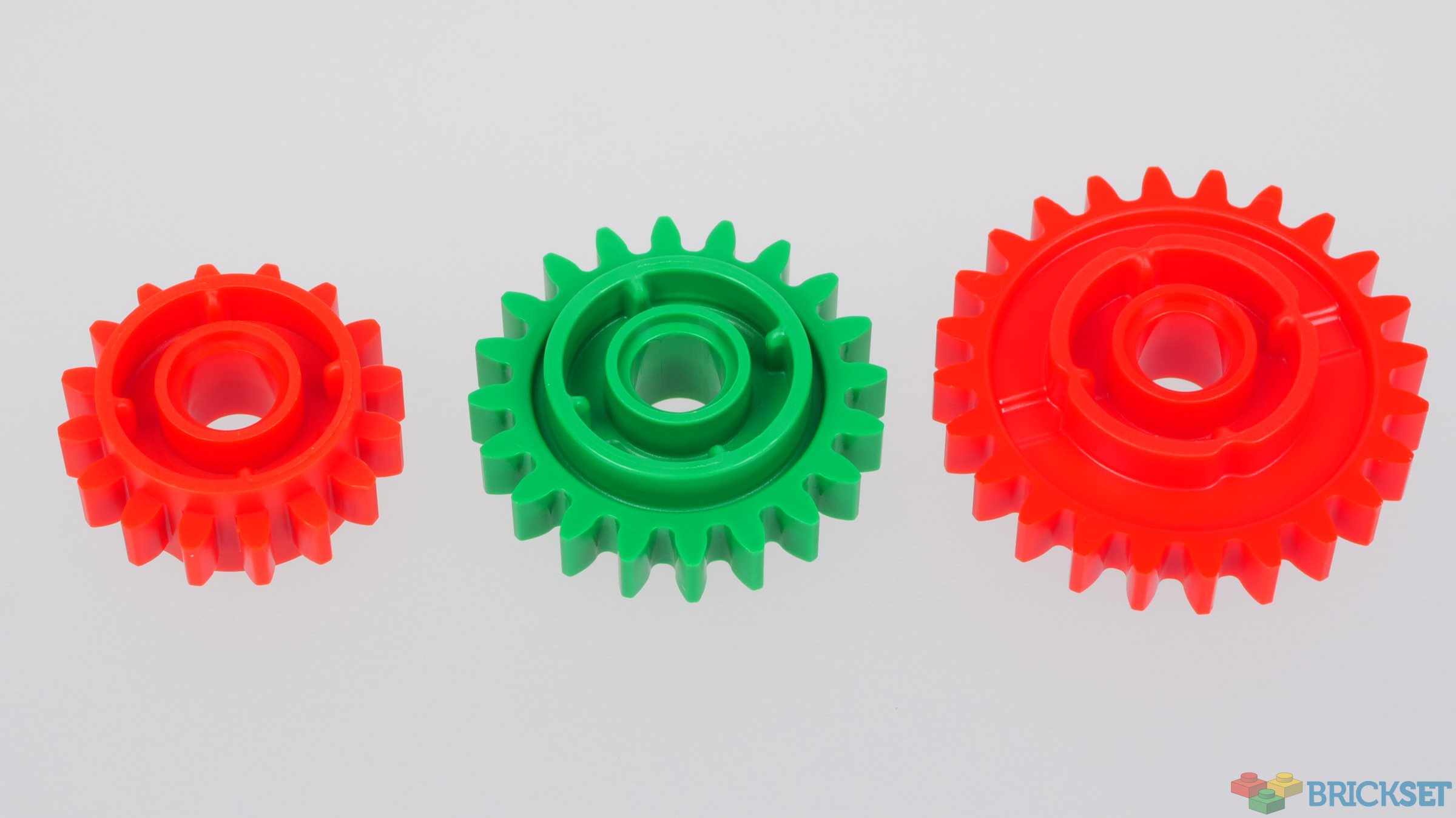

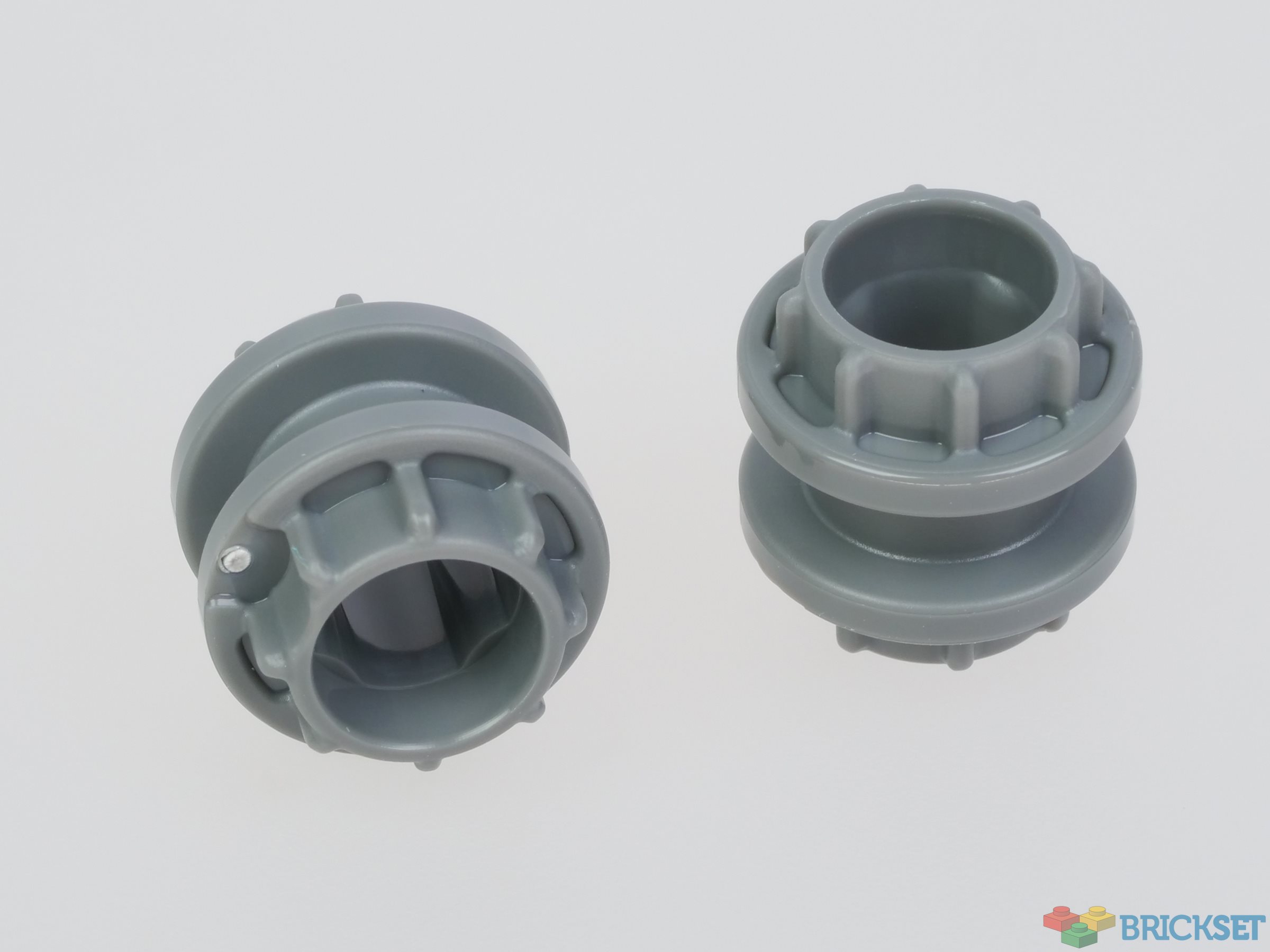

The compact gearbox has been made possible by four new parts and a new size of clutch gear.

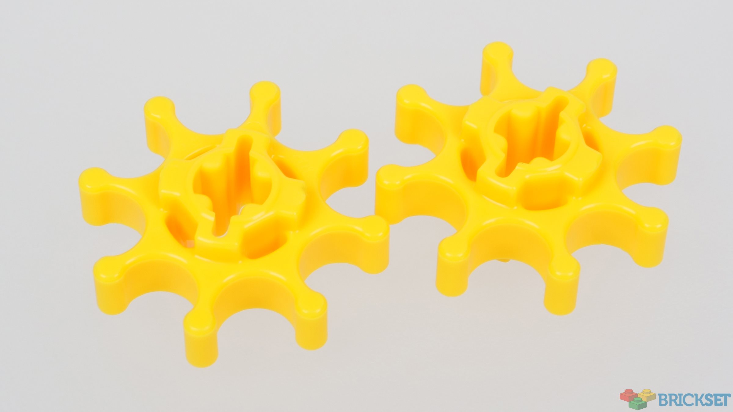

The key to operation is the yellow gear (ratchet drum I believe it's called) in the centre at the top. It is rotated 45 degrees at a time by a push of the dark grey axle behind it, and back the other way by another one below, which are connected together by a rocker mechanism that, when the model is complete, is operated by the foot pedal.
As the yellow piece rotates, so do the light azure shift drums which in turn cause the orange shift forks below them to move from side-to-side as the red ball pin connected to them rolls in the groove around the circumference of the drums.

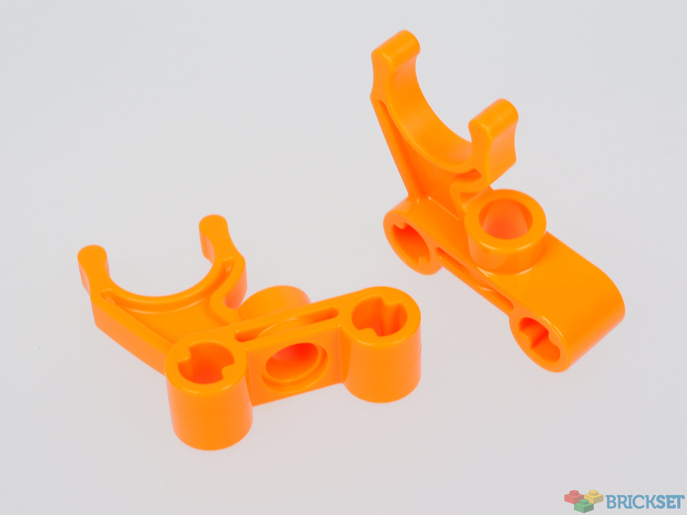

The shift forks then move the dark grey gear shift rings along the axle below, engaging with the clutch gears on either side. In this photo the gearbox is in neutral, with none of the gears engaged.

These are the new parts. The large red clutch gear is new, the green one appeared for the first time last year. The light azure shift drums have letters engraved on the edge to assist with alignment in the model.
I predict that they will revolutionise gearbox design and will most likely replace those that have been used before now.

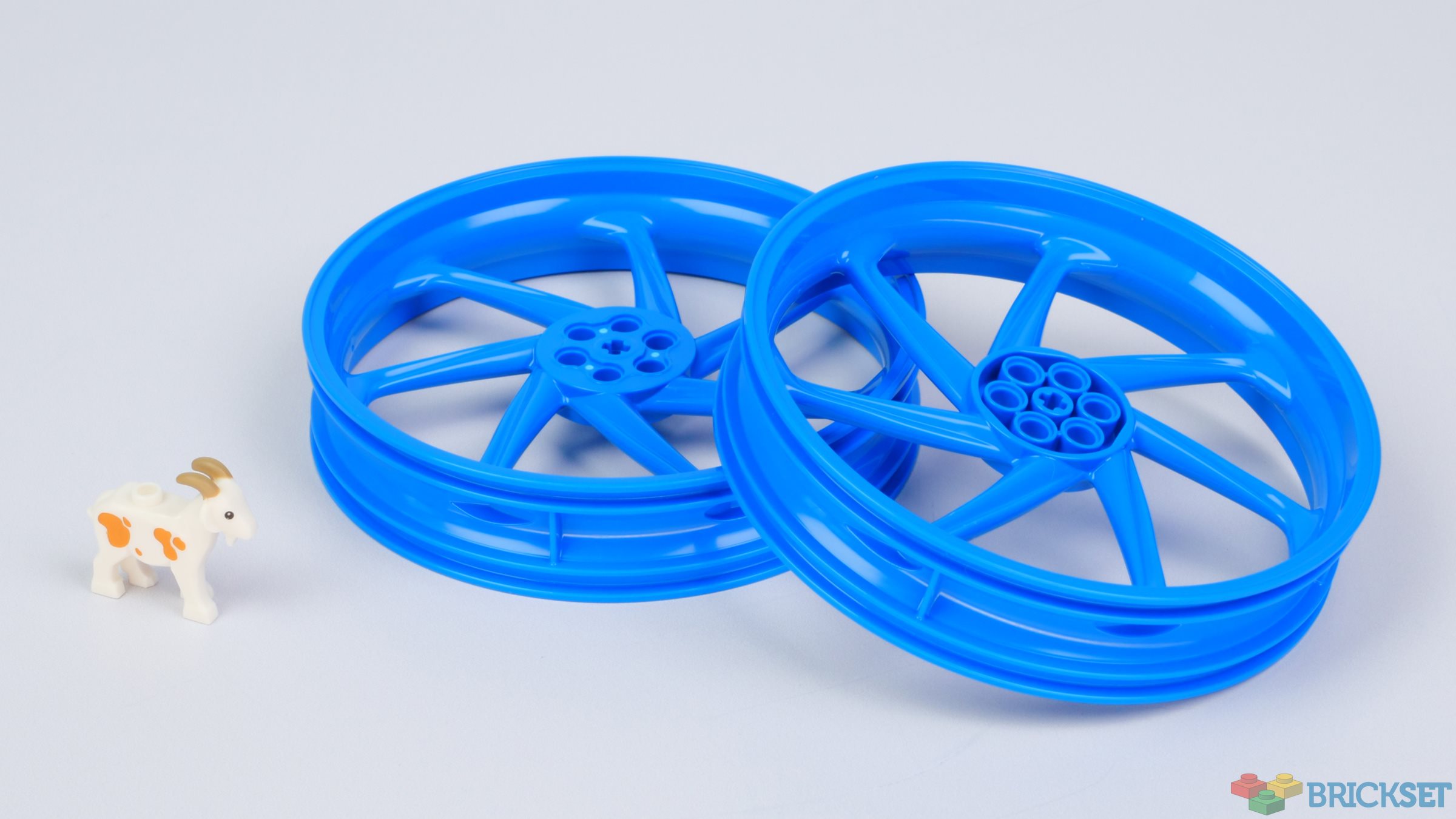

The wheels were used first in 42130 BMW M 1000 RR and have been recoloured here in blue. If you don't have that model it may be hard to envisage just how big they are, so I've included a goat for scale.

I understand the enthusiasm for the new gear shifter parts, but aren't they overly convoluted? For example, the orange shifter forks have to run on two axles, that is already pretty complex. I wonder if they could have worked a bit more on simplifying the parts and the setup.
Having 45 degree operation rather than 90 degree is better, though.
The previous system with the orange shifter wheel was at least very simple.
I can see the yellow star shaped cog being used for many decorative purposes though.

"Are those tyres on the right way? they both look like they are going in different directions."
I think the front one is turned the wrong way around, yes."
If that's the case it is wrong in the official images and instructions.
The tread pattern appears to match the photos of the prototype.
