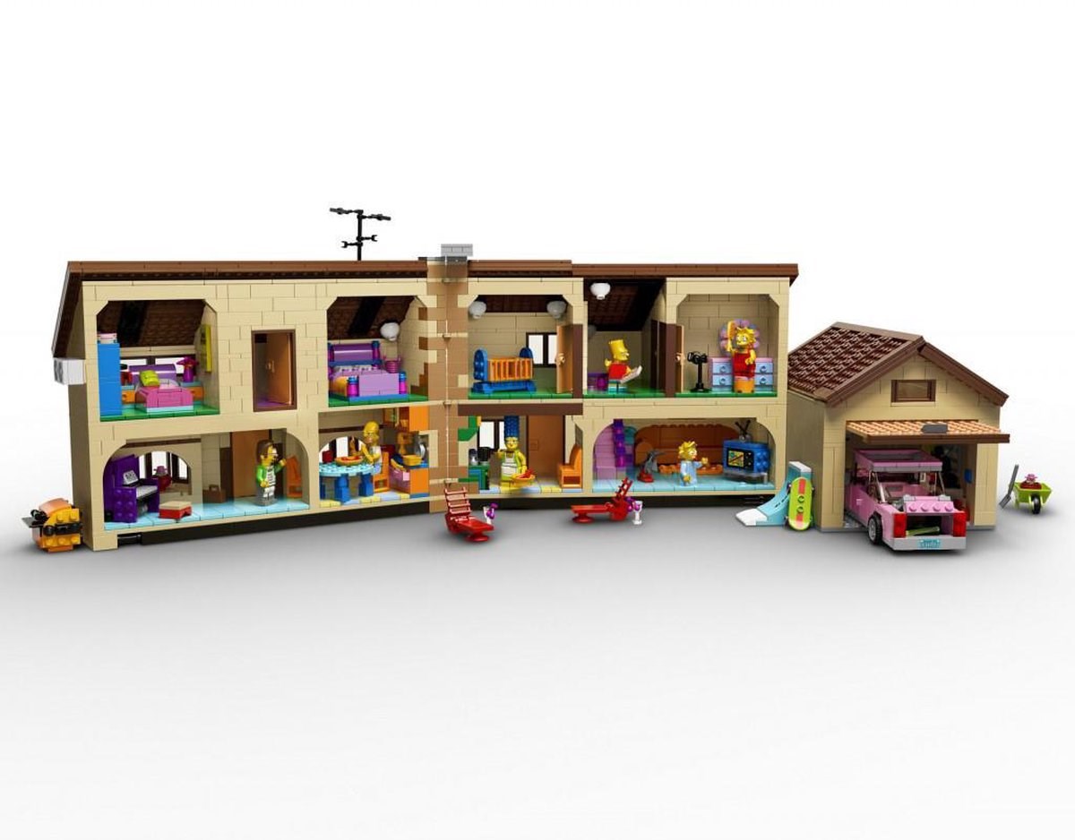

Hinge pieces can also be used to make bigger parts turn than just a wall. Early examples of this include 374 Fire Station and 375 Yellow Castle, where entire portions of the building are placed on separate baseplates which can be turned to access the inside. A more recent example is 31012 Family Home, where the hinge separates the garage from the living quarters. This build also uses tiles in order to lift the two upper floors up.
Dan Siskind’s 3739 Blacksmith Shop from 2002 and 71006 The Simpsons House from 2014 are both hinged along the chimney so that they can be split in half to see inside. Why along the chimney? Slope brick roofs look best with one stud overhang on all sides of the building. But the axis of the hinge has to be on the outside of the building for it to open up, which in this case means on the outside of the overhanging roof.
A chimney protruding from one of the walls cuts through the roof and thus makes for a perfect new outside hinging axis. The disadvantage of this is that the fireplace is always split in half when the building is opened up. This can be fixed by moving it a few studs aside.

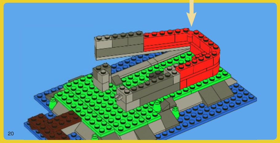

I cannot really understand the last method based on the text and image. Can you provide some image of Town House with Garden from the back? Also, it is referred to by a wrong set number (376). Furthermore, I do not understand what the relevance of 376 Low loader with Excavator is to hinged houses. Can you please explain?

"I cannot really understand the last method based on the text and image. Can you provide some image of Town House with Garden from the back? Also, it is referred to by a wrong set number (376). Furthermore, I do not understand what the relevance of 376 Low loader with Excavator is to hinged houses. Can you please explain?"
It was supposed to be 376-2 : House with Garden. Google this name and you will see two hinges, one connected to the baseplate and another under the roof.

I also appreciate the chimney-hinge to flip open the buildings, double dollhouse-style. 10228 flips open the same way as well, and it's just so satisfying to open it, or close it up again. I am but a simple man with simple tastes.

“The disadvantage of this is that the fireplace is always split in half when the building is opened up. This can be fixed by moving it a few studs aside.”
Could someone explain to me what this means (if anyone actually makes it back to this article)? I may be a day late and a dollar short.
@blogzilly:
If you run hinges down the back of the chimney, when you split the building open, half of the fireplace faces one way, and half faces the other, while a gap is created in the center of the fireplace. One suggestion thrown out was to hinge the chimney on the corner or the side, so the fireplace itself would be left intact.
" @blogzilly:
If you run hinges down the back of the chimney, when you split the building open, half of the fireplace faces one way, and half faces the other, while a gap is created in the center of the fireplace. One suggestion thrown out was to hinge the chimney on the corner or the side, so the fireplace itself would be left intact."
Thanks…has that ever been done in an actual set?
@blogzilly:
Splitting the chimney/fireplace down the center, absolutely, several times (they even posted an example). Hinging it down the side of the chimney, I don’t know. I don’t pay a ton of attention to buildings that aren’t GCPD, Wayne Manor, or Arkham Asylum.

There are several solutions that retain a four-walled design but still leave the interior accessible. Open-back designs limit how expansive a structure you can build. Something like 21330, 21336, or 21328 have rooms located behind other rooms, and the only way to access them is from above. MOCs that I’ve seen done with open tops have been several feet across, and a hanger bay is much easier to access with the massive roof missing instead of just a tiny wall.
I bought two sets of model 3661 . I built one normally and the second set was built "mirrored". High and low refers to using a hinge at the top and at the bottom. You connect the two halves this way. It is by far the simplest and least expensive option to hinge a building.
This method works best on smaller sets as a larger set would be too big to swing open down the middle. For larger sets a different method of making the back wall swing open is preferred.
You can have the back wall of a large set swing open as one piece or you can have it swing open split down the middle.
