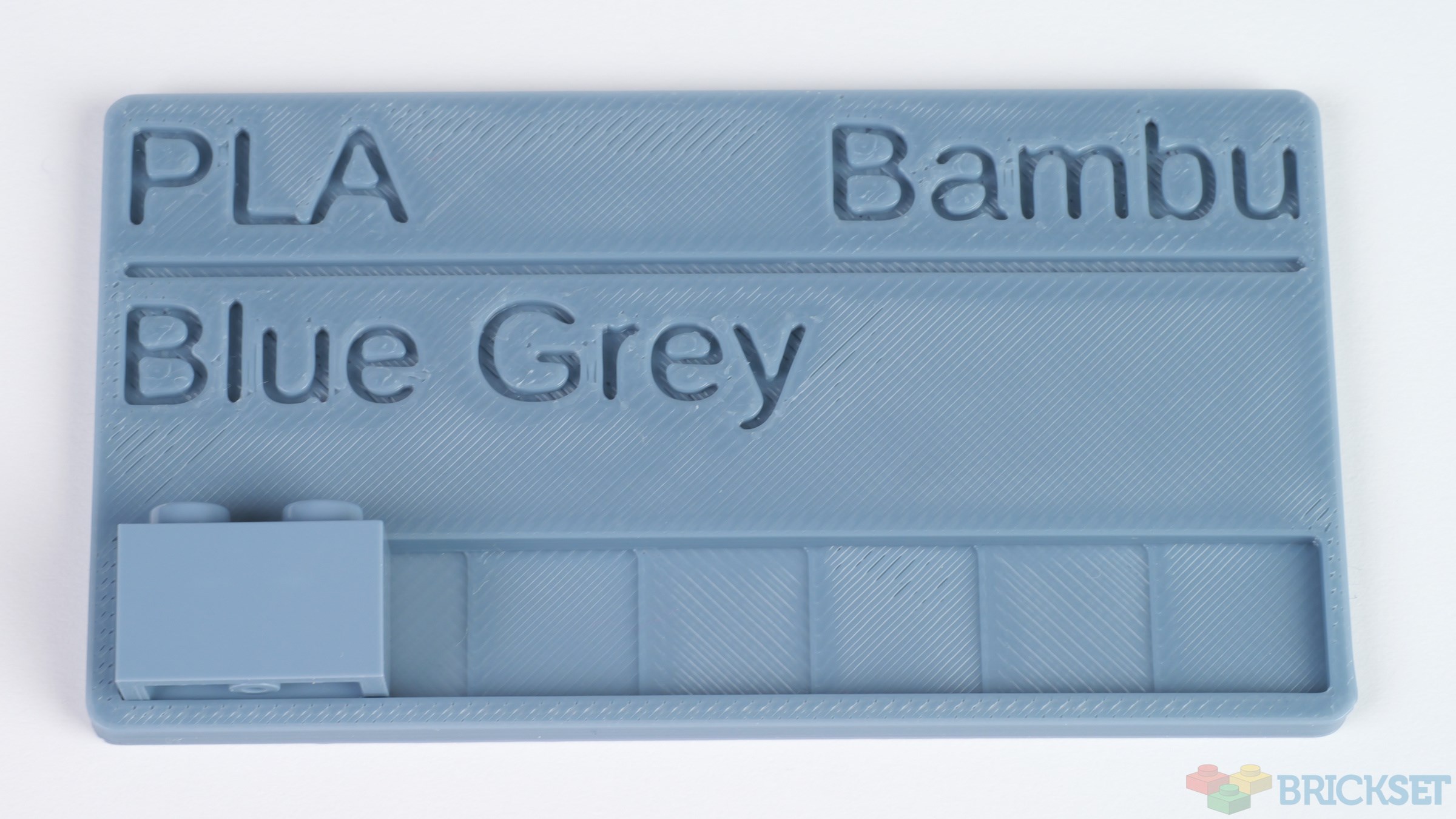

White, black and greys
You would expect white to be an easy colour to match but LEGO white has a yellow-y tinge to it so many white filaments look too white. Bambu Jade White PLA also has a yellow tinge, so is a good match.
Matching the exact shade of light bluish grey has proven problematic but Overture light grey Super PLA+ is close, and Bambu grey is not far off.
Both Bambu dark grey and Sunlu grey are a good match for LEGO's dark bluish grey, with Sunlu being slightly closer.

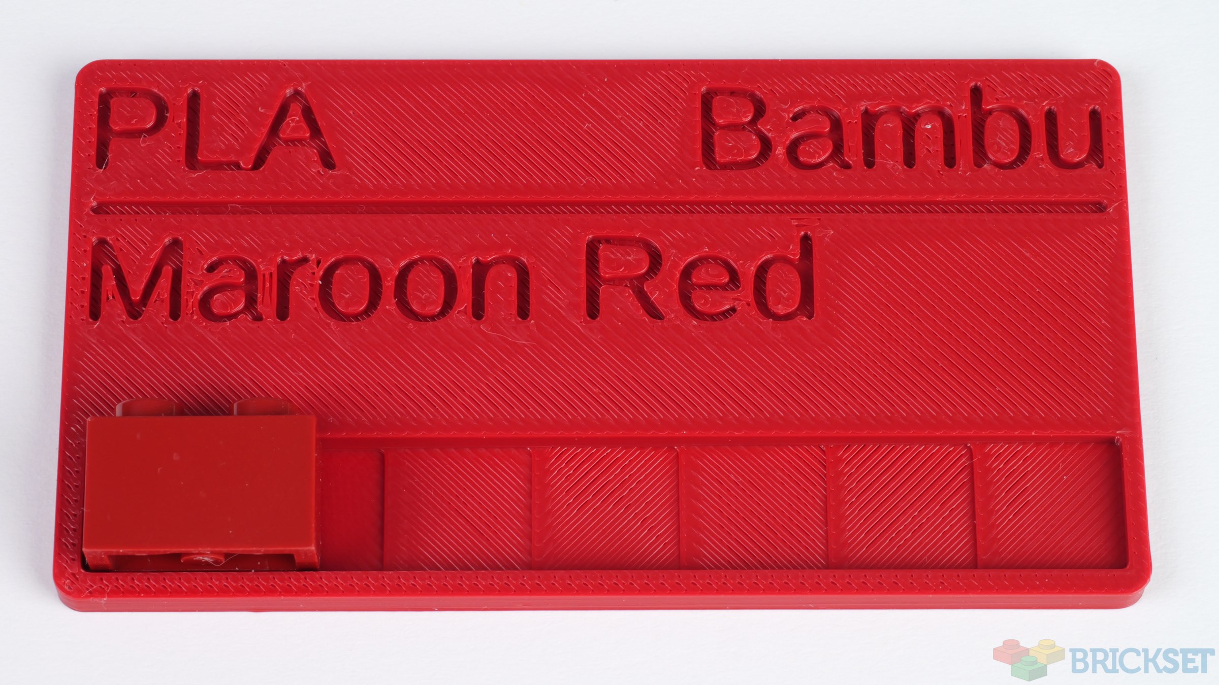

Red, orange and yellow
The red end of the spectrum is much easier to match with both Sunlu and Bambu offering colours that closely match LEGO hues.
Bambu and Sunlu reds are pretty much identical.
Bambu maroon red is almost a perfect match for dark red.

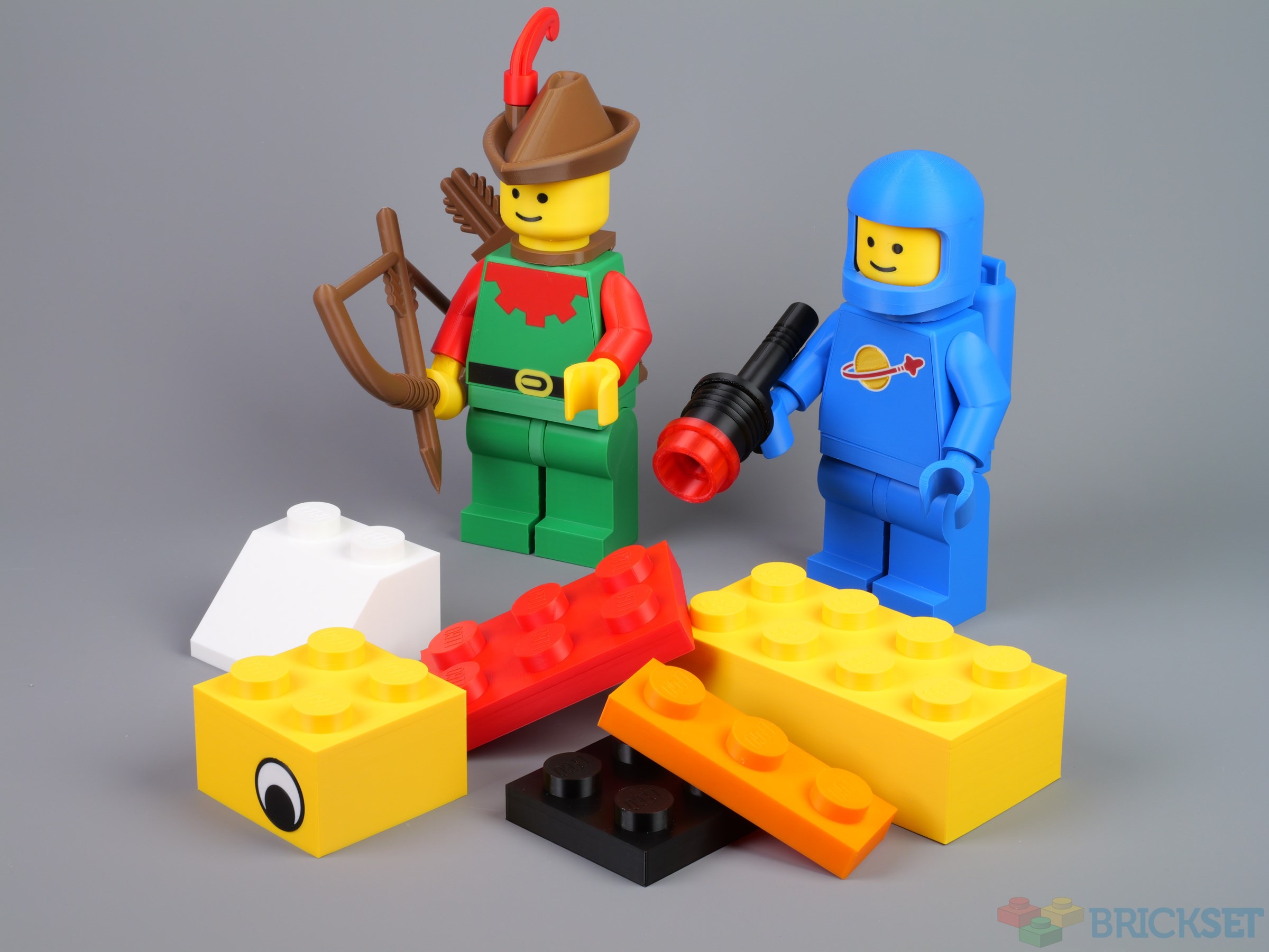

When you get the colours right, printed parts can pass for the real thing:
Banana for scale...
The photo shows 5x scale parts printed on my A1 mini which are all functional. The Forestman uses eSun brown, which is not as red as the current LEGO brown but looks to be a close match for old brown that would have been in use in the 1980s when the figure was produced. Unfortunately, I don't have any bricks in that colour any more to compare it with.

Wait so are those articulating giant minifigures? I suddenly want to get into the 3D printing craze…
@LukeSkywalker said:
"Wait so are those articulating giant minifigures? I suddenly want to get into the 3D printing craze…"
Yes they articulate in all the right places, so can be posed as you like, but the joints are much stiffer.

The smiley faces are 'layers of different coloured plastic that go all the way through the model'. As each layer is printed the printer prints the yellow bit, changes to black, prints the black bit, prints the black bit on the next layer, changes to yellow, and so on. It produces a lot of purge waste to ensure no colour bleeding but the results are excellent.
The fronts of the torsos are printed face down then glued on to minimise that."
