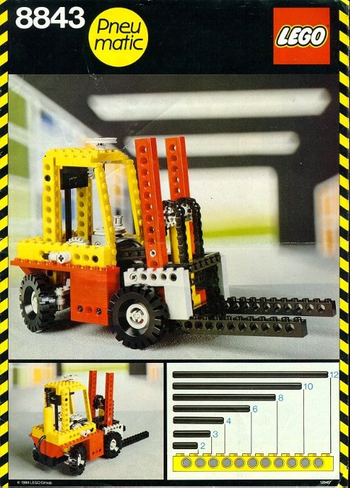

8843 Fork-Lift Truck, from 1984, was one of the first pneumatic sets. It uses a large pneumatic cylinder to raise and lower the fork, via a chain, which is pretty much exactly how many real-life ones work, albeit using hydraulics rather than pneumatics.
The first generation of LEGO pneumatic cylinders did not work particularly well because they had just one air inlet, at the bottom, which was used to both blow air in (raise the fork) and suck it out (lower it), which is less efficient than blowing into a top inlet. LEGO sorted this out with the second generation of cylinders released in the 1990s.
Nevertheless, this is a realistic looking model of a compact fork-lift of the sort you'd find operating in warehouses.
