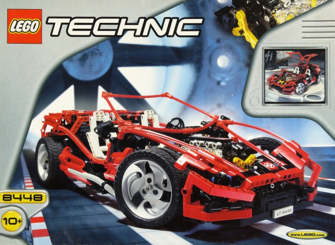

8448 Super Street Sensation (1999) V8 Yes Yes Rear 5+R
Note that already the second set on the list features all five basic car components. The last two sets are considered by many to be the pinnacle of the supercar line. From a technical point of view, 8880 is the clear winner here with its four wheel drive. However, if you want to use LEGO to explain car technology, then 8880 is an overkill, while 8448 offers the same components in a much more transparent package. Moreover, the gearbox also features reverse. True, it does not have the Ackermann steering, but this is not such a big deal. Add to it the much improved aesthetics and it is no surprise that for many, 8448 is the king.
8448-1Super Street Sensation
8448
8448 Super Street Sensation: the ultimate Technic Supercar?

I agree with the points about 8448. For me that's still the best Technic car set. Sorry Porsche and Bugatti.

Thank you Huw and pHabala for publishing this. 8448's combination of studded beams for the chassis and sweeps and blends for the body in my view makes it both an engineering classic as well as a real beauty. If only new replacement pistons were readily available.

Growing up, the 8448 was long one of my grail sets. I finally managed to pick one up a few months ago used but in good condition. I like the current Technic automobiles just as much from a technical point of view, but 8448 is still my favorite for nostalgia and the use of the damped shock absorbers.

The 8448 Super Street Sensation was the set that brought me out of my dark ages and I still think the wheels on it are some of the coolest looking wheels ever to feature on a Technic set (what with the silver color and the swirly design)

I always thought 8448 was a dumbing-down of the super car line; it lost the 4wd and 4ws of 8880 and gave us instead a couple of different alternative bodywork designs. That made it much more superficial in my eyes. 8466, which I have always loved, gave us 4wd (not just a rear diff as mentioned in the article) and cool damped doors, so despite not feeling like a super car it had more complications than 8448.
