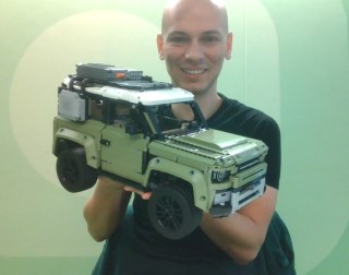

A few weeks ago we had an opportunity to interview Milan Reindl, designer of 42110 Land Rover Defender, via Skype, to ask him about working on the model and also about other Technic sets that he's designed since joining LEGO as a Technic designer in 2012.
It's a fascinating interview: Find out how LEGO worked with Jaguar Land Rover to bring the model to fruition, how the scale and colour of it was chosen, and how he managed to squeeze the gear box in.

On this model, if you look at the shoulder line along the side, that’s something that was very distinctive on the new Defender and something the JLR design team really wanted to have there. We could have designed a Technic piece that couldn’t be used anywhere else afterwards, or we could use System parts. That was the easiest and the best working solution.
Were there any features you wanted to add to the set that you couldn’t fit in?
I don’t think so, other than perhaps more gears in the sequential gear box. But four was the most we could squeeze in due to the size of the vehicle.
I think it pretty much ticks all the boxes for an off-roader: it has very nice bouncy suspension, steering from the rooftop and inside the cab, a very complex gearbox, a cool the locking mechanism for the rear doors, and also extra play features like the luggage and storage space on the roof rack. I’m really happy with how it turned out!
