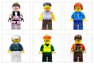

And here I present you, what may be the first AI generated LEGO minifigures, totally dreamed up by my computer:
How does it work? The algorithm needs some minifigure pictures -- training data -- to learn what a minifigure looks like. It works best when the pictures are as uniform as possible, so the Bricklink / Brickset database is excellent for that use. I have extracted 4500 minifigure pictures from a few themes like City, Collectable Minifigures, Star Wars. So in this data are not only human figures, but some fancy aliens, disguised ones etc.
It all works thanks to two software algorithms, the generator and discriminator. The generator generates fake minifigure picture using some random input numbers. Then it feeds those generated fake images to the discriminator, along with real minifigure images. The discriminator's task is to distinguish fake images from the real ones.
The better the discriminator does the job, the higher reward it gets, but it also means that the performance of the generator is not good enough, so it has to do better next time. When the generator generates more realistic images, the discriminator’s performance is not good enough. So it is like a game between two players where each one wants to outsmart the other and each of them learns gradually over time how to do that.
I used Google’s cloud service to do the computing. Just after about ten minutes of training on real images you could easily see the shape of the generated minifigure.
Then I left the algorithm to learn for about eight hours and below are some of the generated images that I got. These are rather blurry but you can easily see some torso and face prints on most of them.
Here you can see some common man with brown jacket and orange shirt. He is probably from a licensed theme due to the skin tone.
And here we have something what looks like a Stormtrooper leak from the fourth STAR WARS trilogy.
To oppose the Stormtrooper we have ninja rebel pilot.
Here are some more examples that my computer dreamed up:
What is the most interesting for me is that it learned some consistency. If one leg has printing, the other have it also, yellow head minifigures has yellow hands etc.
Which is your favourite generated minifigure? What may be the next step? Maybe AI generated LEGO sets?

Why didn't it learn that Minifigures have crisp, definable edges rather than vague nebulous smudge like areas of both colour and form?
@Bricklunch said:
"Looks like the software is sponsored by Specsavers.
Why didn't it learn that Minifigures have crisp, definable edges rather than vague nebulous smudge like areas of both colour and form? "
Training pictures were 128x128 pixels, so quite a low resolution. The quality of generated minifigures depends on the time of training and values of some parameters, and setting the best values of this parameters is the key thing. Unfortunately there are only general rules of what values these parameters can take and these rules are often task specific.

Hi Pawel. These are really promising results! Having worked a bit with GANs myself, I know how hard they can be to train. I think before you move on to a new project, it would be really cool to see more progress on this one :) It would be amazing if you could get the network to generate minifigs that look good to humans (e.g. with sharper edges/less blurring).
Can you share some more details on the specifics? For example, what network architecture and hyperparameters? What loss function?

After the feedback I am definitely planning on developing the project further. :)
Generator is just simple transposed convolutional architecture to upsample latent space to the size of the image, than its output is fed to the discriminator that downsamples it to get the class probability - 1 for real image and 0 for fake. So the discriminator loss is comparing output for real images to ones and fake images to 0. Generator loss is a comparison between ones and fake images output. There are also some tricks that help in training to be more stable, like adding noise.
