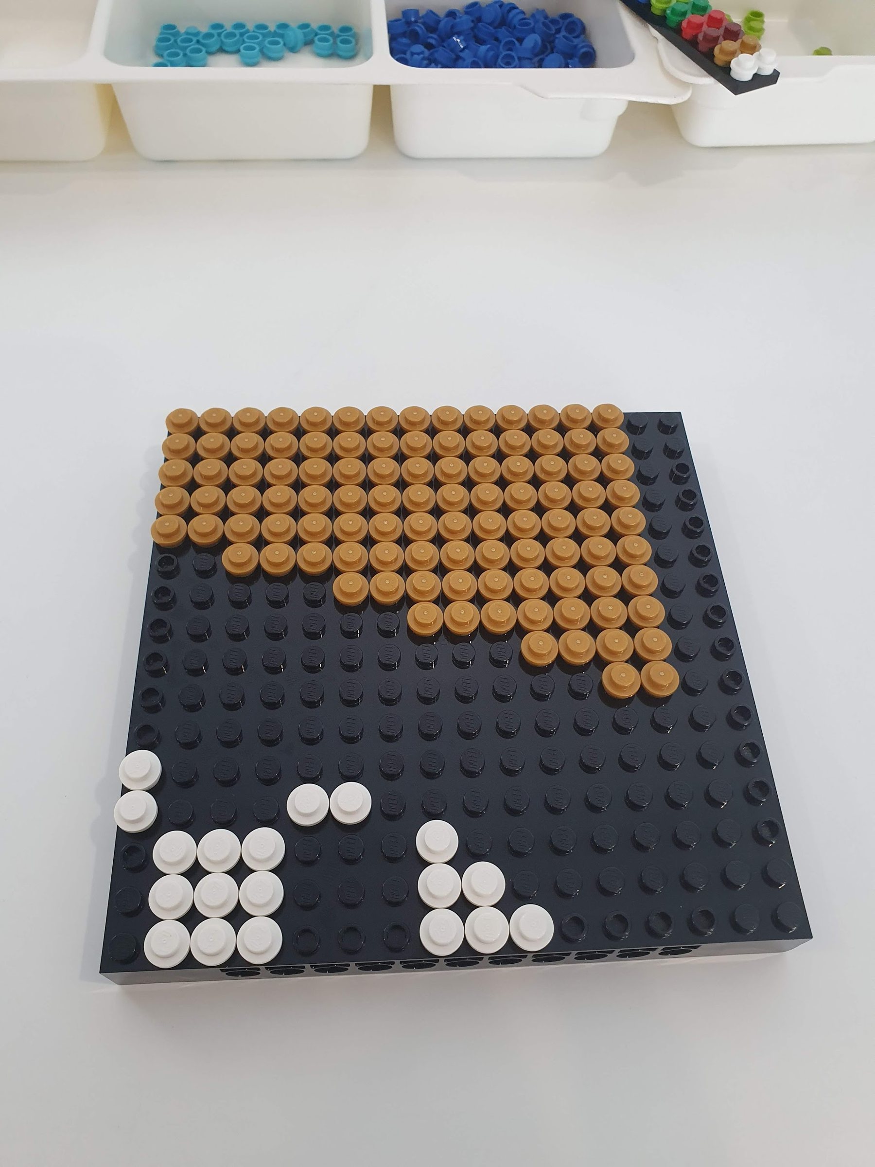

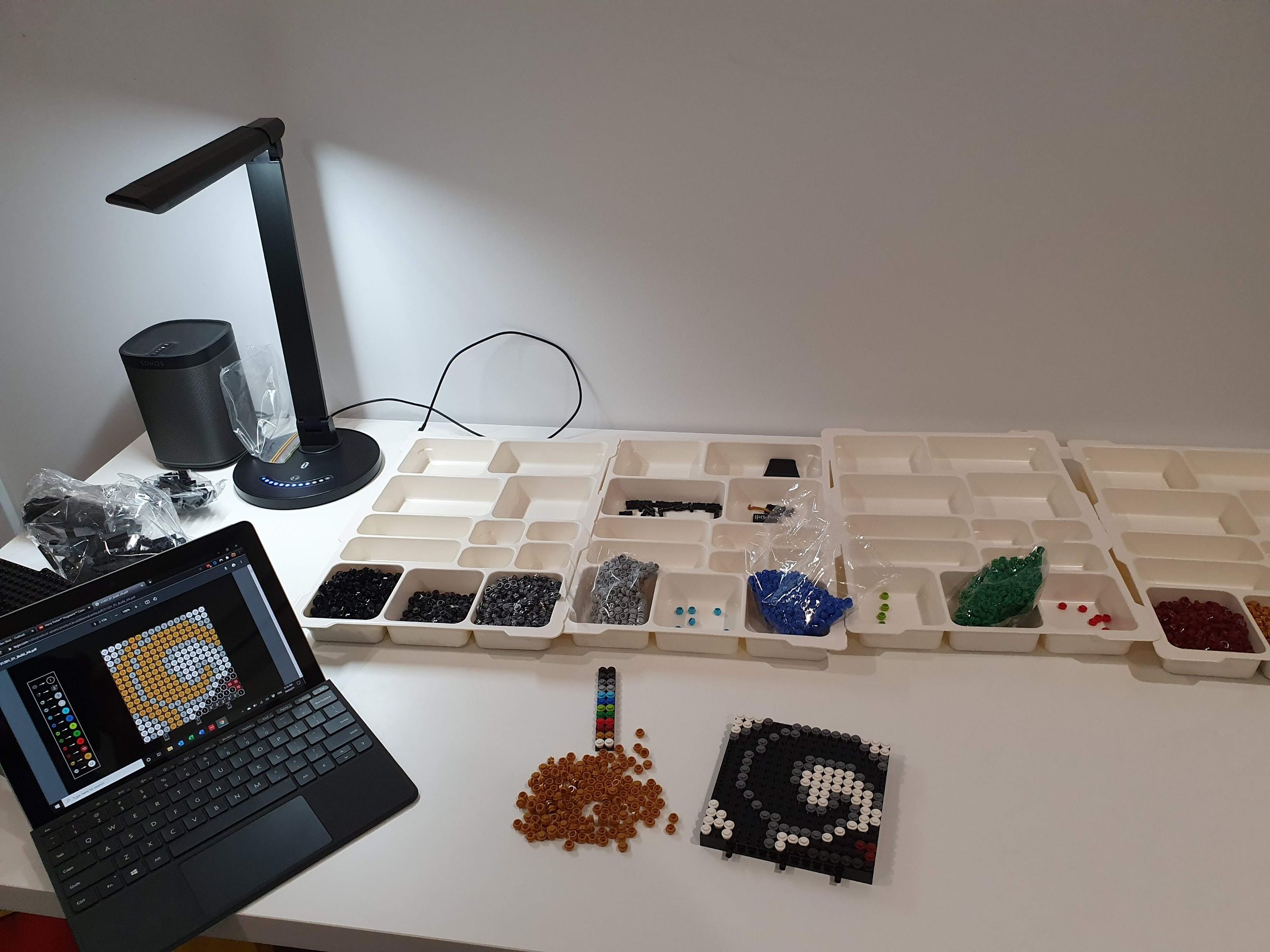

Being a Ravenclaw, I first built the bottom right corner of the crest, and had only one full set opened. I wanted to see how close to finishing it could I get with just one of the four sets. You might think "that's easy, of course you can finish it", but remember it expects you to have four times the normal number of studs in any one colour, so I wasn't at all sure. In the end it got very close, having just 10 studs missing.
My suggestion is to ensure you have all colours clearly separated out, as it's not that difficult to get confused by the grey ones, see my setup here. You'll need a tablet/computer handy, as the instructions in the sets only have the standard build, not the alternate 4 x set build.

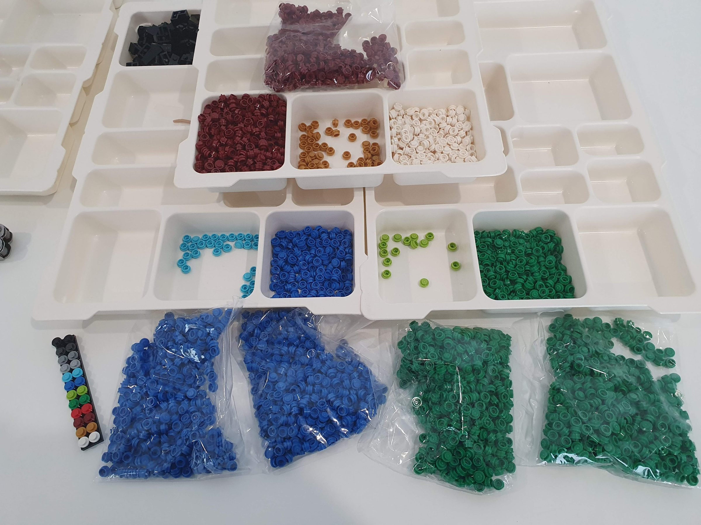

By the time Slytherin was finished I had just started to run out of studs for one colour.
Now was the tricky part, building the fourth quarter of the set, Hufflepuff. Some colours I knew I had more than enough of, but others I was confident I would run out of quite quickly. The first one or two 16 x 16 plates were almost complete, but as I got further and further along more and more of each square was blank.
When I had built all I could, I had a look at the total studs I still had leftover, and boy there were a lot! I had actually opened one too many of the Dark Red bags, so if you're doing this, keep two of the three bags sealed.
