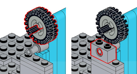

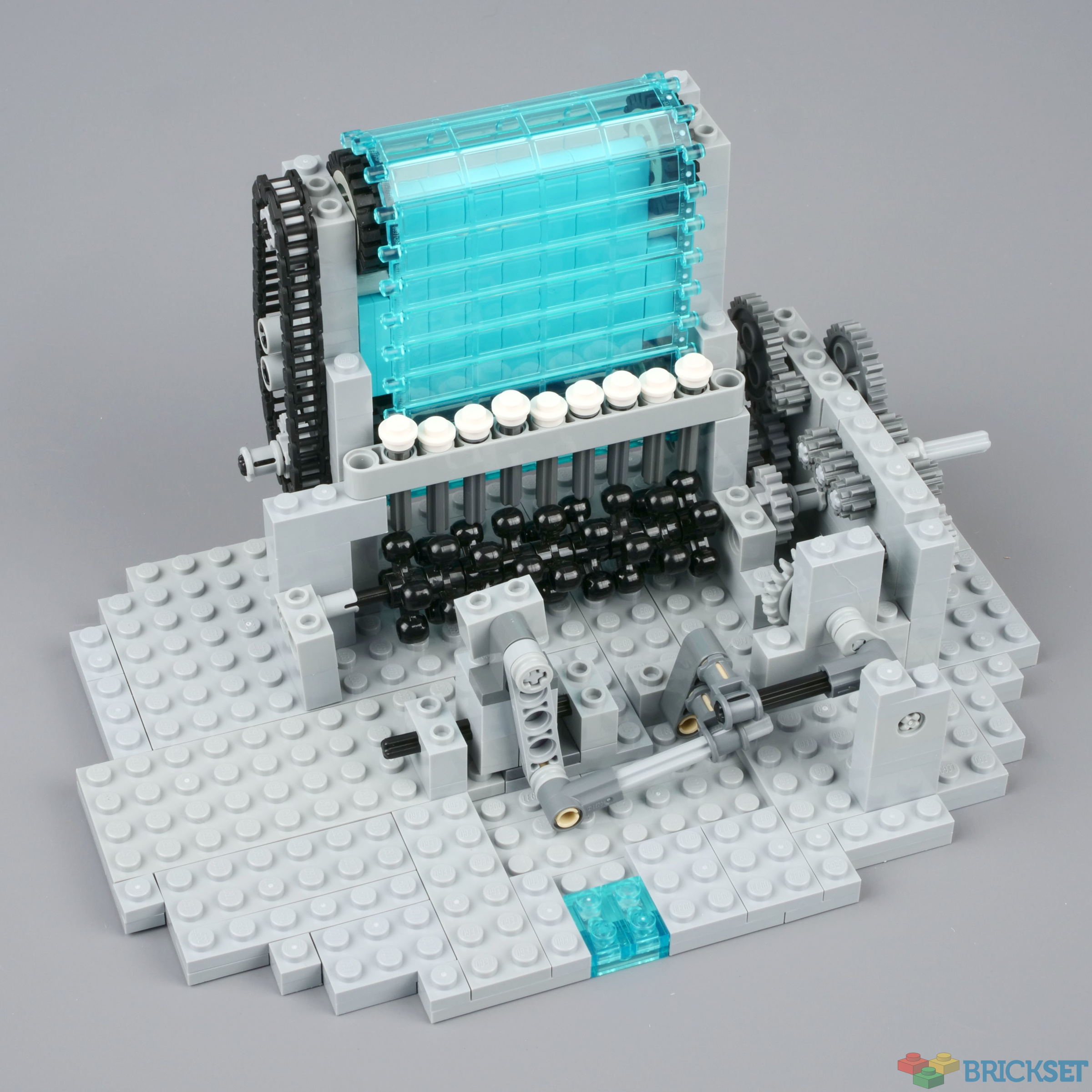

It then moves onto the waterfall and this is where the issues with the build process start. There are a few steps where technic beams are slotted over axles and onto plates. I think at this point the waterfall mechanism could have been built separately as a sub-assembly and then placed onto the base when it's finished, that way the vertical parts could have been assembled before sliding them over the axles.

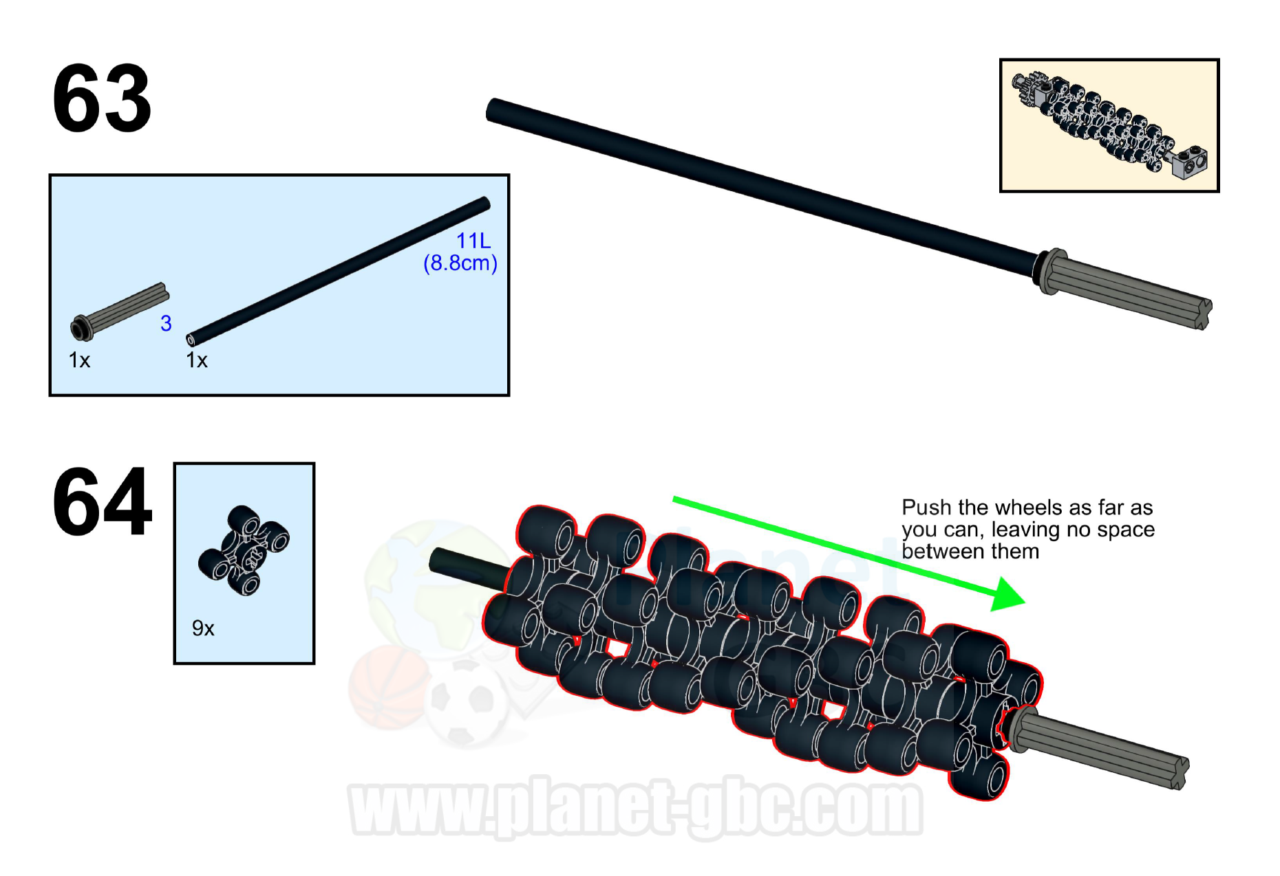

The way the water splashes work is a set of 32072 TECHNIC ANGULAR WHEEL on a length of flex tube that is slotted into a pin at one end and a 6587 3M CROSSAXLE WITH KNOB on the other. The tube only slots into the axle by a millimetre or so it can come apart quite easily [This is the part that broke when Alice built it -- Huw]. It works well as a clutch though so winding the mechanism the wrong way won't break anything. When I built it, the tube was slightly longer than the gap it was placed into, a trim with a blade for the brave would solve this.
This section of the build finishes off with constructing the linkages that make the boat rock. It's an interesting mechanism with an unusual way of offsetting pieces by a fraction of a block. At this point, all the mechanics are built, but there is a feeling of fragility because all the linkages and axles are supported on pillars of bricks with no interleaving of layers to provide strength.

I suspect that the set’s fragility both during its construction and when in use is due to it having been designed using CAD and then not properly tested with actual bricks. Connections and construction steps that look fine on screen may not work so well when subject to real forces and gravity.
