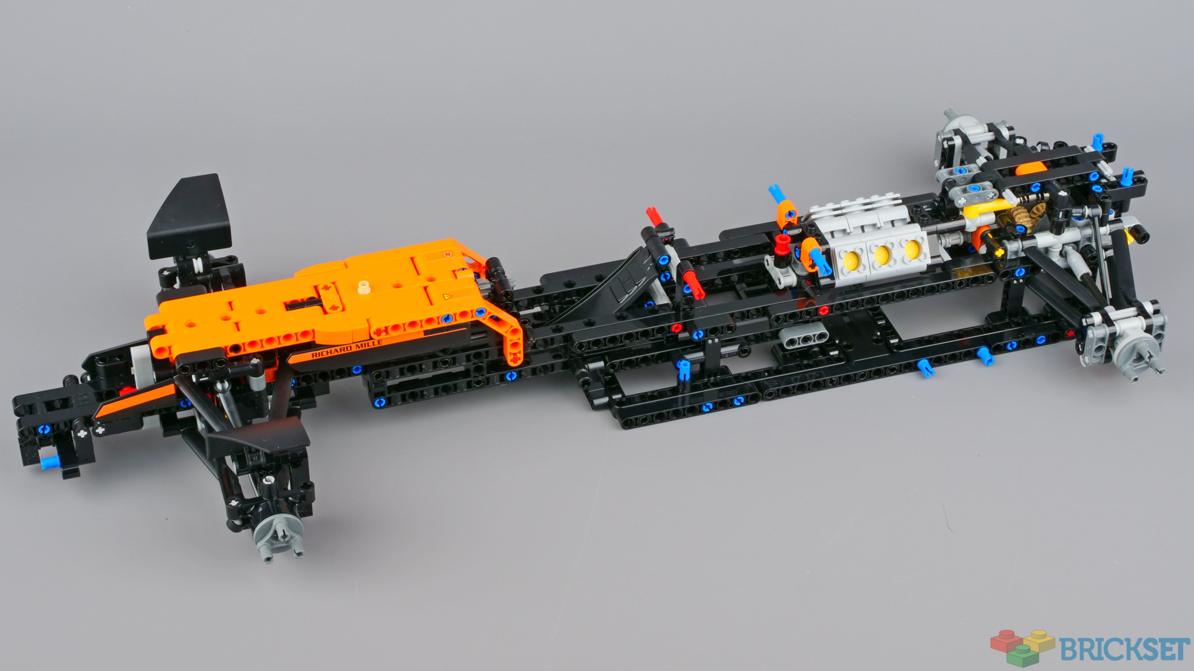

Functionality-wise the model does not offer a great deal, and that which it has is mostly concentrated in the rear axle and engine assembly, which is the first section to be built.
The 6-cylinder engine is connected to the rear axle via a differential, and suspension is provided by two springs mounted horizontally in the centre of the assembly.
Front suspension is also facilitated by horizontally mounted springs, under the orange section.
