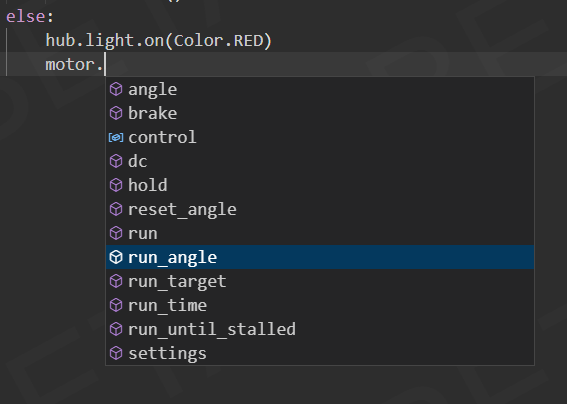

Code-completion provides prompts as you type, to remind you of object methods and so on, which further simplifies learning it.
