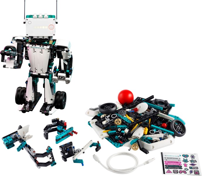

We had a sneak peek at the new 51515 Robot Inventor at the recent virtual fan media days, so I've had a chance to give it some thought.
Technology-wise it is identical to 45678 SPIKE Prime released earlier this year, which is something of a relief for me because I've invested heavily both intellectually and financially into the educational kit.
You may recall that in an article I wrote in February about using Spike Prime for GBCs, I stated "LEGO is not marketing Spike Prime as a Mindstorms replacement, even though it pretty much does everything that EV3 does, and then some. Given that EV3 is now 7 years old it's obvious that it will be replaced by a Powered Up-based product in the not-too-distant future. I'm not a betting man, but if I was, I'd put my money on it being very similar to this."
It appears that I was spot on except that Spike Prime is being marketed as a Mindstorms replacement.
It's interesting that LEGO appears to be delineating its educational and consumer robotics product lines from a marketing perspective this time. The third generation of Mindstorms, EV3, was called Mindstorms whether it was intended for home or classroom use, but now that's not the case. The educational one is Spike, the consumer one, Mindstorms.
Spike and the Robot Inventor share the exact same motors, hubs and sensors, albeit with different colour cases and in different quantities (see below). However, they will have different software development environments, although I will be surprised if they can't be used interchangeably. The Mindstorms one will be geared towards playing, the Spike one towards learning. Both will enable code to be written in Scratch or Python (the Spike app has been updated this week with Python support).
The hub in 51515 differs only from the Spike one, below, in that it has a teal base instead of a yellow one. They both have a 5x5 LED matrix, a rechargeable battery, a micro USB port and bluetooth connectivity. It can be powered from the USB port while running, thus making use in an exhibition environment possible.

Spike Prime contains one large motor and two medium ones. Robot Inventor comes with four medium motors, which are coloured light grey and white, but no large one. However, I believe a grey-coloured one will be included in one of the August Technic releases.

Spike Prime comes with a distance sensor, a colour sensor and a touch/force sensor. Robot Designer does not come with a touch/force sensor because, it was explained to us at the fan media days, in most use cases the colour sensor can be used instead, and that is certainly my experience.

As far as the other parts in the sets go, many of the new elements introduced in Prime, such as the biscuits, wheels, Technic building plate and large frames make an appearance in 51515 Robot Inventor, too, albeit in different colours. The Mindstorms set comes with some circular wheels that I am not familiar with (but which I've been told is this one that's included in 75253 Droid Commander), rather than the metal ball bearing castor wheel found in Spike.
